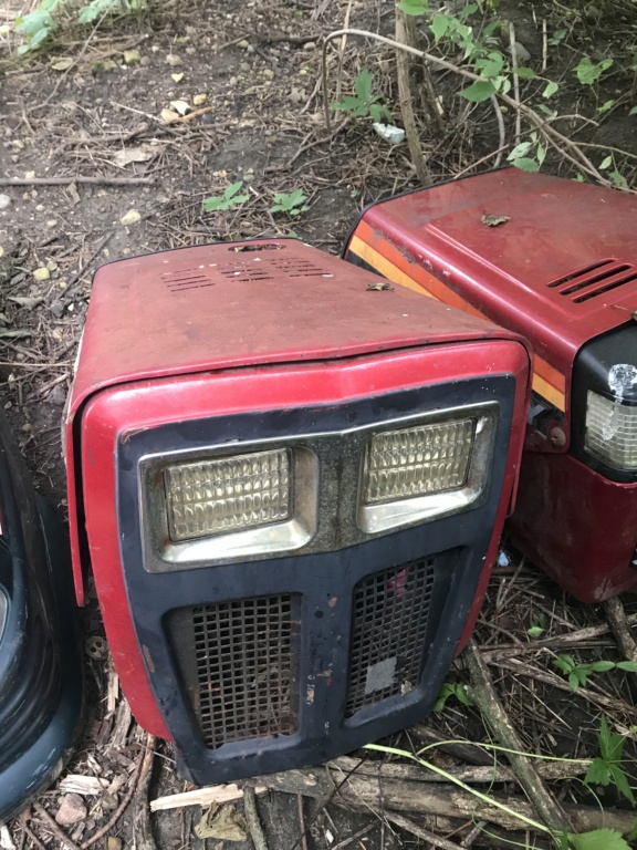

| - CraftsmanQuad19 wrote:
- Here are more pics as promised. My exhaust I got, the current hood, as well as the Murray hood. The issues I have with the Murray hood are that it has the hole for the gas cap, but isn’t centered, and the hole for the exhaust (had a briggs single) in the side of the grille.
Found your Thread a bit late LOL I do like your Build! I would go for the Morray Hood that's right next to this hood, they look very nice and should barely fit a Vanguard twin I measured. | |
Age : 23 Join date : 2016-04-12 Points : 5530 Posts : 2617 Location : Indiana
 | Subject: Re: CraftsmanQuad Mark II December 6th 2018, 6:29 pm | |
| I think for now I’m gonna run the factory craftsman hood. At least until the rest of the tractor is sorted out. 820, front axle/suspension, shifter, belts, pulleys, frame reinforcements, etc. the hood is an easy final touch lol | |

 | Subject: Re: CraftsmanQuad Mark II December 7th 2019, 10:52 pm | |
| Now that the buildoff is over, back to this thread! Got a new oem hood and is cut to fit, but needs moved forward and up a couple inches, I think I’m going to cut a couple inches off the end of another craftsman frame and keep the stock style hinge. Should fit something like this:  | |

 | Subject: Re: CraftsmanQuad Mark II December 8th 2019, 12:43 am | |
| I think that look with the angled down craftsman hood is pretty cool. That's kinda the look I'd like to go for with the Broadmoor RS project. Looks fast! | |

 | Subject: Re: CraftsmanQuad Mark II December 8th 2019, 6:32 pm | |
| I second that. I've always loved those style hoods. They're probably one of my top 3 favorites. Always wanted a Craftsman like that one but I ended up with Murrays. Have too many projects now to ever do real build with one. Either way, it looks a whole lot better. | |
