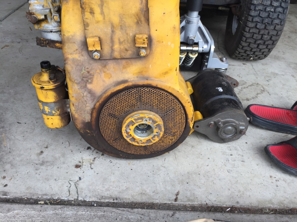

this is my engine
CUB CADET 104 Puller Img_0712
Points : 8043
CUB CADET 104 Puller Empty
PostSubject: Re: CUB CADET 104 Puller   CUB CADET 104 Puller Icon_minitimeAugust 25th 2018, 9:51 pm
Nice! K Series are great old engines. Is that thing bolted to the blower shroud a bracket for the fuel tank or something?

PostSubject: Re: CUB CADET 104 Puller   CUB CADET 104 Puller Icon_minitimeAugust 30th 2018, 12:52 pm
Yes, I have allot of parts collecting to do before I get something going here...

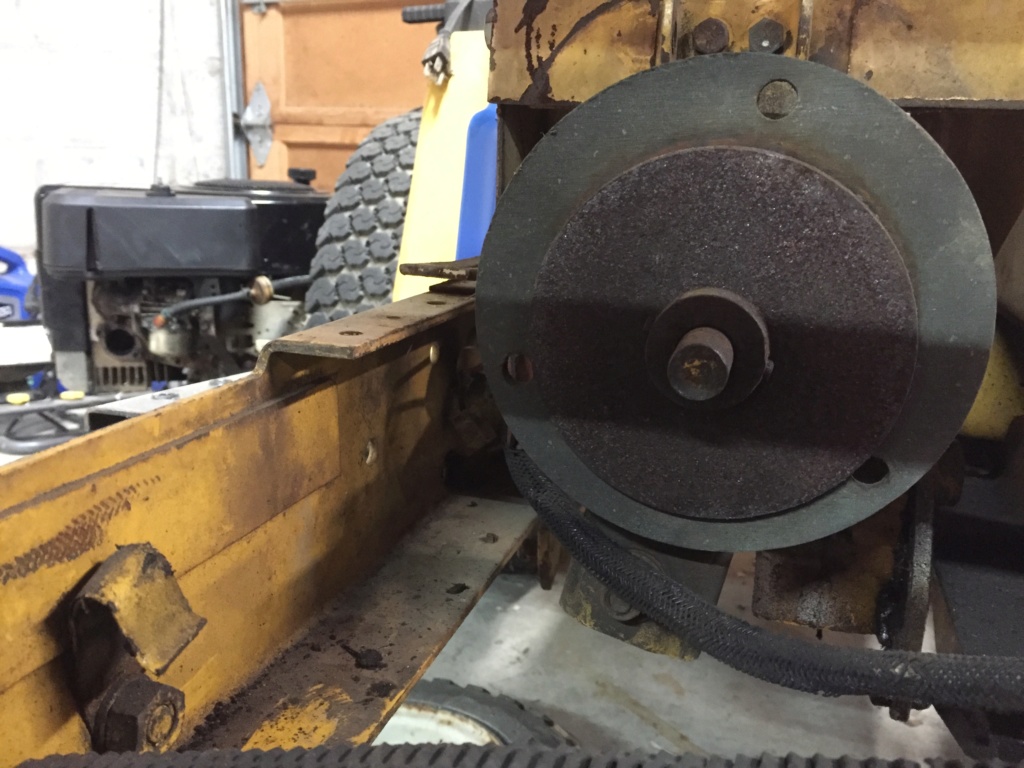

I am still trying to figure out what I am missing and why this part looks off center.... I am not 100% how the engine connects to this...

PostSubject: Re: CUB CADET 104 Puller   CUB CADET 104 Puller Icon_minitimeNovember 11th 2018, 8:56 pm
I'd look up an exploded parts list and try to figure it out.
Points : 8043
PostSubject: Re: CUB CADET 104 Puller   CUB CADET 104 Puller Icon_minitimeNovember 11th 2018, 9:00 pm
Hmm, wonder if there's a coupler that's supposed to go between the clutch mechanism and the flywheel.

PostSubject: Re: CUB CADET 104 Puller   CUB CADET 104 Puller Icon_minitimeNovember 12th 2018, 8:11 pm
ok i asked around and got a diagram... there is a thing called a 3 pin driver that mounts to the flywheel and goes in those holes...it costs about 10 million dollars so im gonna have to find one second hand...

PostSubject: Re: CUB CADET 104 Puller   CUB CADET 104 Puller Icon_minitimeNovember 12th 2018, 9:55 pm
Just keep an eye out for spare change, might come across a few million under the couch cushions or what have you. lol!
At least you know what you're looking for now. I wonder if one could be fabbed up from scratch? As long as you had a way to get the measurements the same as a factory one, it might be a possibility. Probably just easier to look for a used one though, haha.
