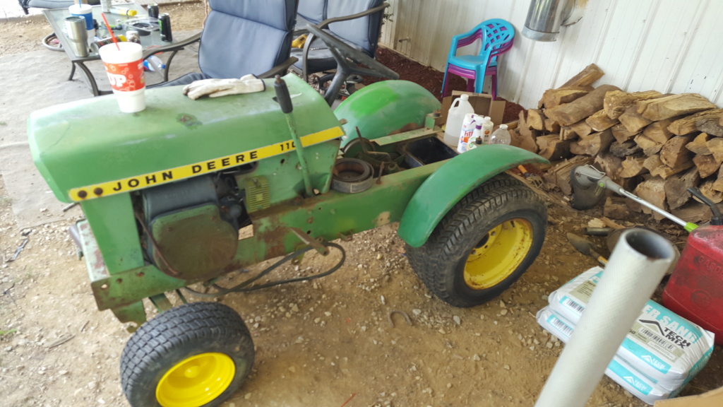

this is the one that I posted that my wife had fount and got for me so far I just order parts for this build it will be built as a garden puller
my round fenders came in today
1973 110 john deer puller 00310
1973 110 john deer puller 00410

Full blown puller build? Very Happy
Points : 8043
1973 110 john deer puller Empty
PostSubject: Re: 1973 110 john deer puller   1973 110 john deer puller Icon_minitimeJuly 20th 2019, 5:00 pm
Looks pretty awesome with the older fenders mounted up!
Really looking forward to seeing this build, I've been thinking about building a B-110 puller myself lately. What all do you have planned for it?

The plans at this moment is get the kohler 10hp runing. I tryed to fire it up yesterday the motor but no luck. But it has such good compression it's not funny but at the moment the points was not working so I ended up ordering a electronic ign for it.
I still plan on going with a 10hp diesel but will probably be after the first of the year
I'm looking at building a 3 point hitch for it
Add some rear ag tires
Fresh paint/dress up a little
Will be a puller but the fancy stuff won't come till part two of this build
But for now my kids will pull stock class with it
Points : 4956
Posts : 2639
PostSubject: Re: 1973 110 john deer puller   1973 110 john deer puller Icon_minitimeJuly 21st 2019, 12:56 am
Well, the later year 110s, especially the ones with the super overcomplicated blade engagement and the starter, they have a magnet and coil inside the flywheel. The coil commonly goes bad, and the OEM ones are super expensive (like $120), but you can buy Tecumseh ones that are much cheaper (I think I paid $24 for mine) and they work just fine if you use a shim. But you're in for a bad time getting to the coil, having to tear the front of the engine off and then pull the flywheel off, and you also have to unwrap the stator to pull the coil off, meaning you'll have to rewrap it in order to have a charging system again. It'd probably be less work to just convert it to a 12v ignition.

It is set up for 12v and has a coil sitting up front
Points : 8043
PostSubject: Re: 1973 110 john deer puller   1973 110 john deer puller Icon_minitimeJuly 21st 2019, 10:13 am
Yeah the mag coil under the flywheel was a less common thing only seen on some of the 8hp tractors. All the 10hp ones will use the conventional 12v automotive type ignition system, my 71' does and the later one we used to have also did.
Points : 4956
Posts : 2639
PostSubject: Re: 1973 110 john deer puller   1973 110 john deer puller Icon_minitimeJuly 21st 2019, 10:21 am
Hmm, that's strange.  How does it charge?  The manuals say that all 110s after 1970 were under the flywheel coil ignition.
Points : 8043
PostSubject: Re: 1973 110 john deer puller   1973 110 john deer puller Icon_minitimeJuly 21st 2019, 10:26 am
Well they would've just had a standard charging stator under the flywheel.
