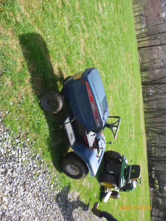

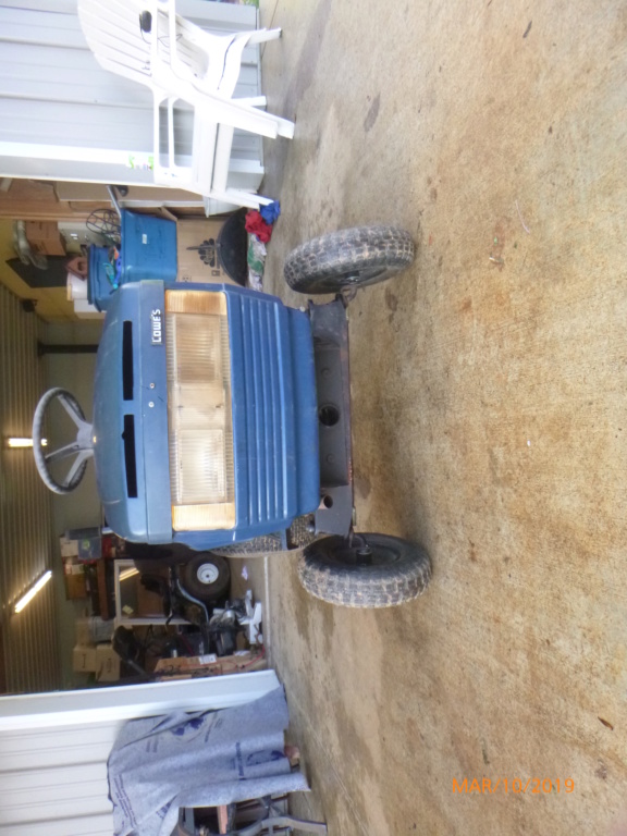

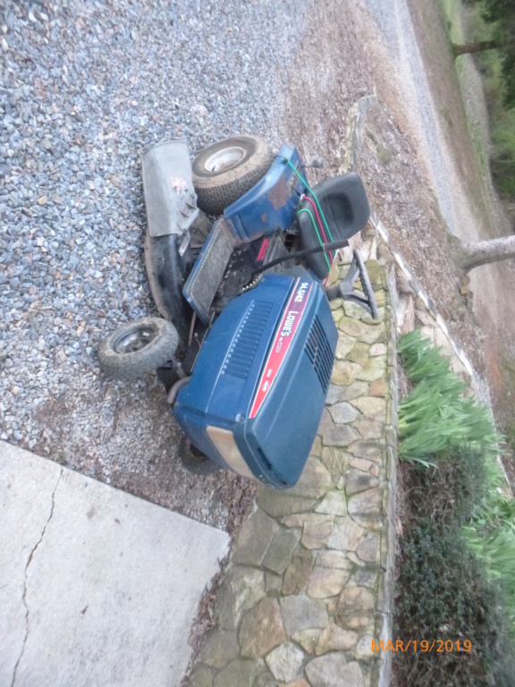

Never mind. i figured out how to do it. Here's all the pictures:
Murraymountain's Lawn Tractor Repairs 20190217
Murraymountain's Lawn Tractor Repairs 20190218
Murraymountain's Lawn Tractor Repairs 20190219

Here's the craftsmans:
Murraymountain's Lawn Tractor Repairs 20190220
Murraymountain's Lawn Tractor Repairs 20190221
Murraymountain's Lawn Tractor Repairs 20190222

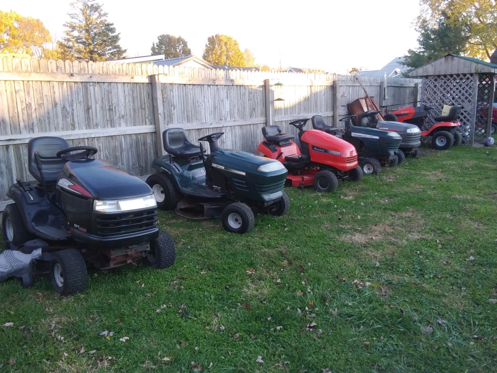

Yea I sold a LT1000 last year for 350, that thing was very nice but the guy who bought it put a quart of oil after it was already topped off and blew it up within the first 10 minutes of use. Poor guy couldn't even figure out how to turn it off before I sold it... what's this world coming to.
Murraymountain's Lawn Tractor Repairs P1080610
I sell them throughout the spring and summer and then when mowing season comes to an end I start working on mud mowers but this year I got that murray in the build off so it looks like I'll be doing both this mowing season. Better make some good money this year lol. I only wish I had parts like that, I have to drive 20 miles every time I need parts like gas tanks, floor boards, tires, seats, stuff like that.
So on the craftsman I've already adjusted the valves several times. The knock is deep within the valve system near the camshaft. Gonna ask some pros if it's worth fixing. But the problem here is that I was using
it as a parts mower cause I just couldn't get to runnin' 'til I some told me what it was, so were I made up time and money by taking parts off of it I lost it here. Oh and the craftsman is definitely in need of some  pressurewashment lol.

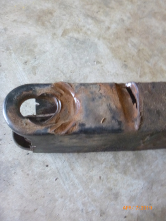

Also pulled the axle today. 30 years of use has caused this...
Murraymountain's Lawn Tractor Repairs P1100618
Totally destroyed. Probably some bad engineering on MTD's part. Anyway I might end up trying some redneck fix on it. Hopefully not, but we'll see.
