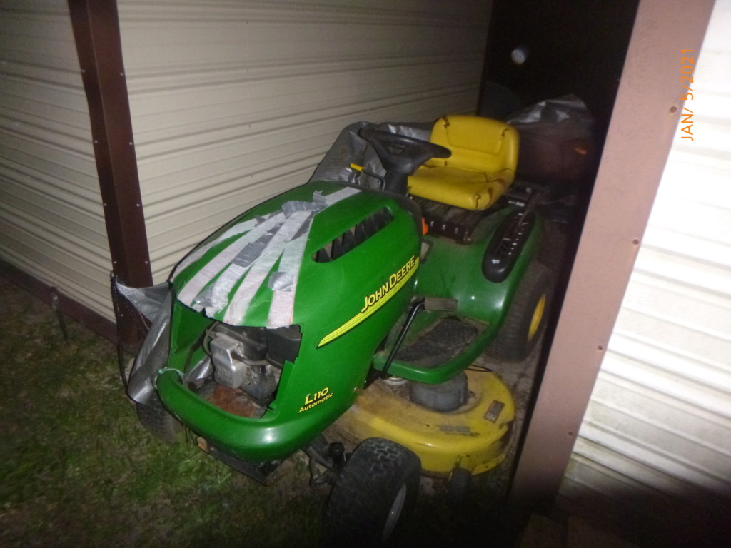

So since I'm back down in FL right now, I figured I'd reveal the 2 tractors we have to pick up that I always talk about.
#1: My grandpas old JD L110...
Murraymountain's Lawn Tractor Repairs - Page 11 P1150913
It's got 524 hours on it. He's been the owner since 2003 when he bought it brand new. He parked it in 2019 when the spindles died on it. He hasn't started it in 6 months. We actually pulled it out tonight with his new E130 and tried to start it back up. The air filter was all molded and everything so we took that right on outta there. Filled up 3 tires, oiled the steering, and dropped the deck. I've yet again found the worst spindle I've ever seen. 500 hours on a spindle really puts the smack down on it I must say. The battery is completely DED on it. We have it on an overnight charge. The parking brake lever is stuck and the pedal won't go down. Haven't figured that one out yet but I'm planning the third JD resto with this one if we get it up to NC this year. Hopefully tomorrow we'll get it charged and she should fire right up.

Welp, we put a battery in the JD and fired right up with the starting fluid until it finally primed the fuel pump and it ran like a top just as I expected. Got the clutch free and now it runs and drives fine. So we pulled the battery and went for the Poulan...
