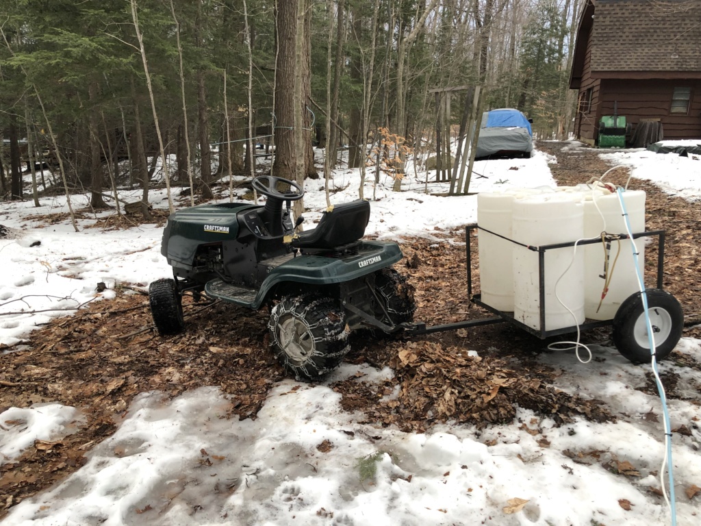

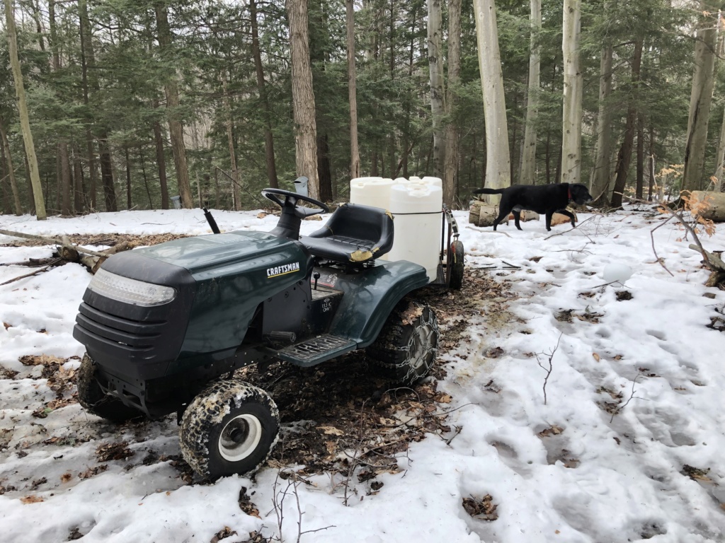

| Hi gang, I need some advice and suggestions before I dive into this. I have a 15.5 hp 6 speed craftsman model 917.272353 tractor with a Briggs &Stratton engine and (I think) a peerless transaxle.
I live on some very hilly terrain in the woods and need to be able to haul firewood, maple sap and similar things around through the woods and up hills. Larger tires with a lot more grip front and back are a top priority along with maybe locking the transaxle. Right now I can bearly steer with snow on the ground and turf tires! I do have chains on the back, but the front is a nightmare. Current front tires are 15x6-6. I have a mig and can weld steel but not aluminium.
Any help you can offer is appreciated because I really have no idea where to start or even where to find tires with some grip in the right size.
Thanks ! Cabby | |

| Thanks gang for the advice. I believe I have 3/4 inch spindles, I will check after hauling in today’s maple sap. Switching to 8” rims sounds like the way to go. Can anyone recommend specific rims? I am worried about getting wheels with the wrong offset or with hubs too long or short for The spindles. Here are a couple photos of what I’m working with.   [url=https://servimg.com/view/20045430/2] | |
