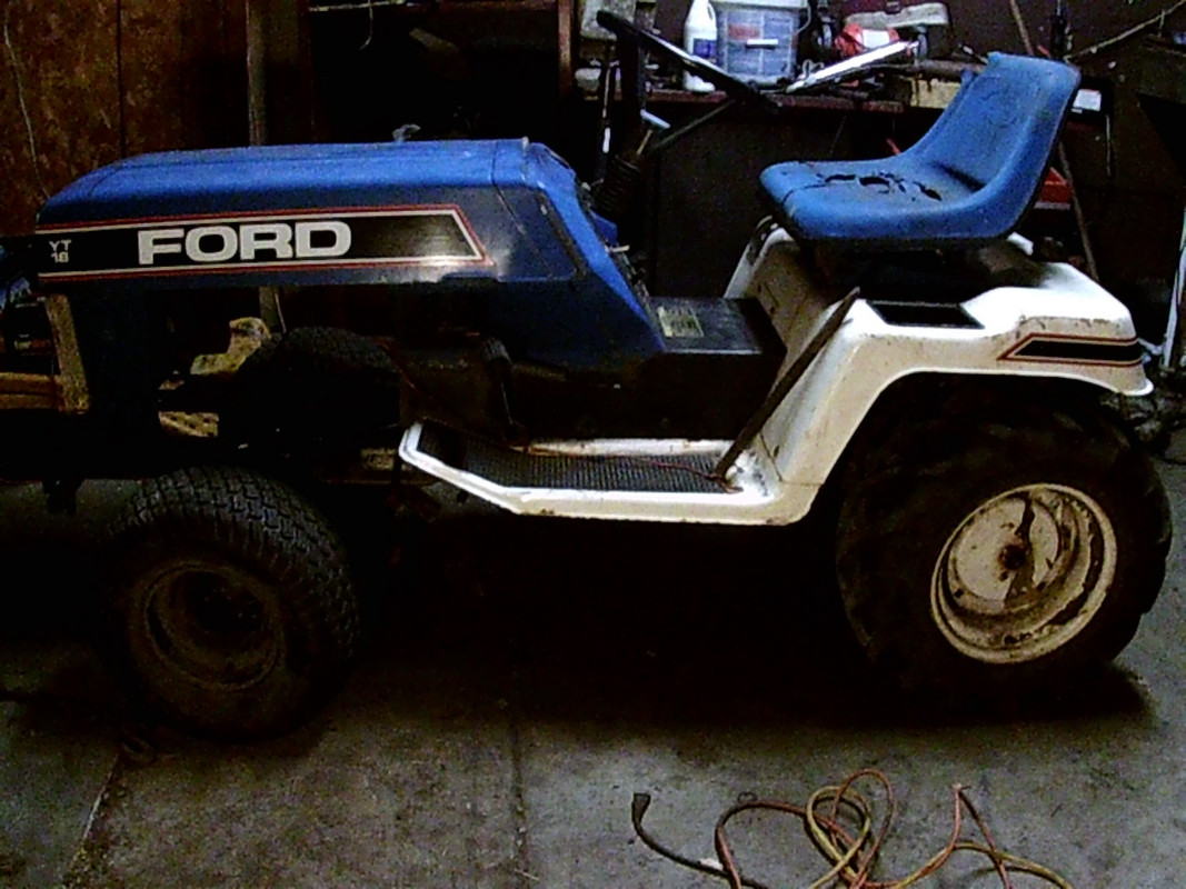

got my tires changed over from the murray
my 80s ford yt16  SUNP0004
pic was taken before i mounted the engine, it is up and running now,and i mounted this ugly ammo can for a toolbox, it will be repainted, problem is because of the gas tank i couldn't mount it to the fender, so i put it on the front bumper

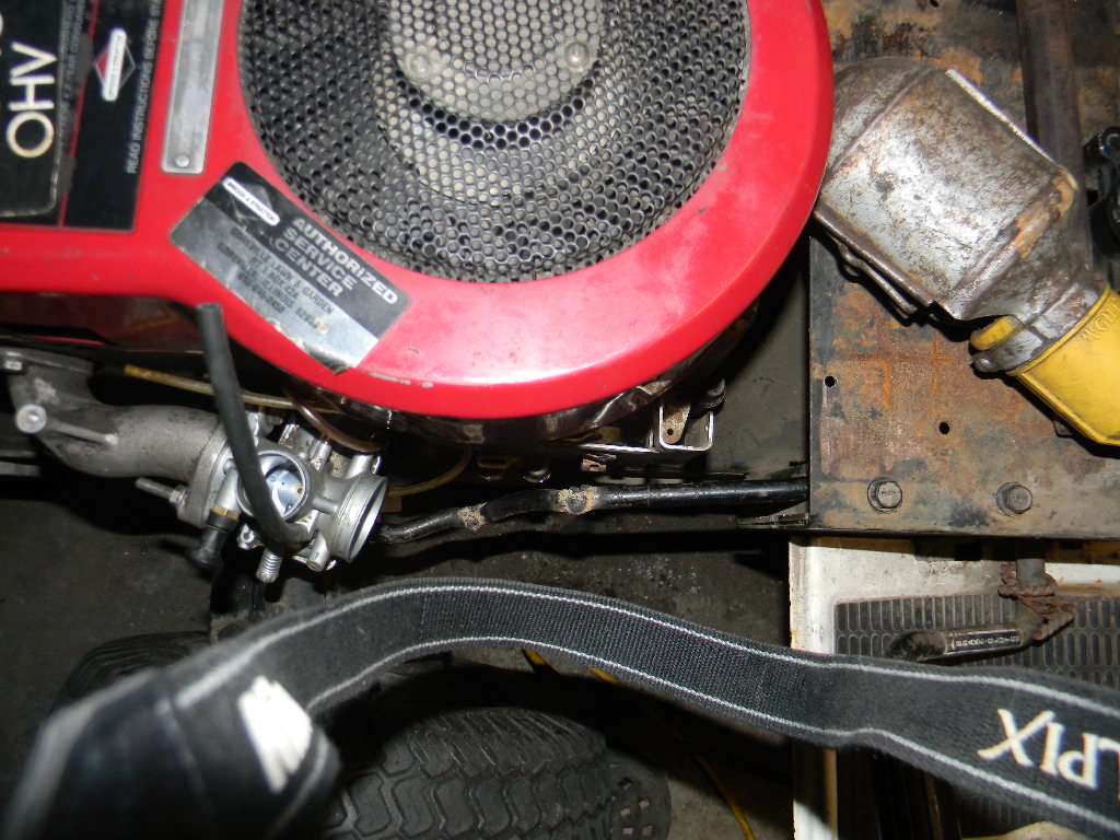

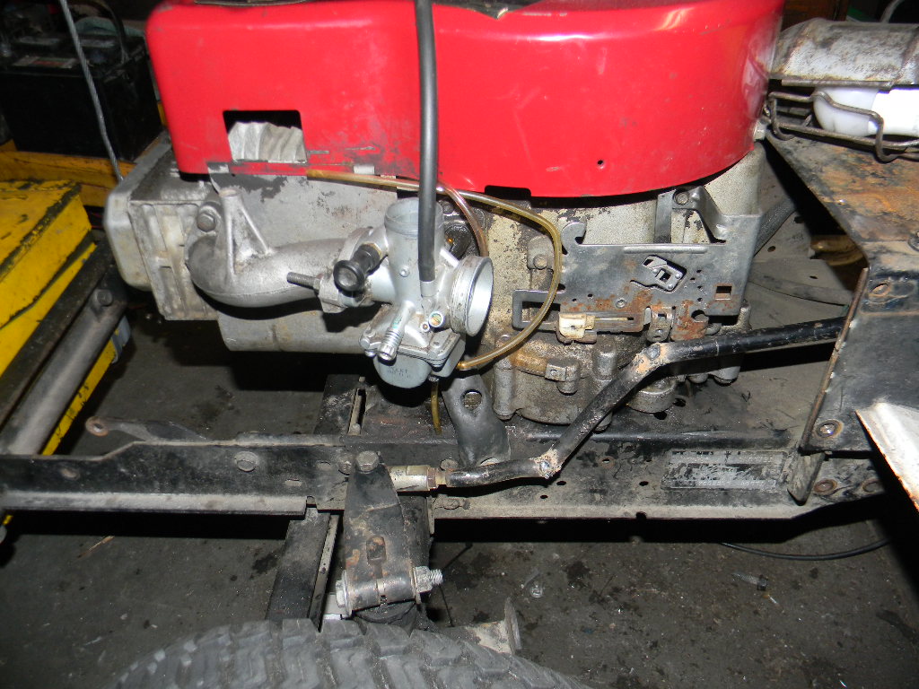

i have the steering figured out just minor things to deal with now, i had to replace the v twin with an older 14.5 single without the oil filter, i was able to cut and weld the drag link so it works with the craftsman steering box, but had to notch the bracket holding the sub frame for clearance most of it's still there so there shouldn't be any strength issues still need to do a little more clearancing though
my 80s ford yt16  DSCN0017
it just clears the motor but i'll remove the throttle control plate to be sure i have plenty of clearance, i.m putting my molkt atv carb on this anyway so none of that is needed, the engine still needs to move over a 1/4in or so
my 80s ford yt16  DSCN0015
my 80s ford yt16  DSCN0016
the only other issue i'm having is the rod end mounted to the pitman arm is hitting the corner of the arm when turning left, so i'm going to have to trim that down a little, then i can finally get the ford back up and on the trails, i think going to this craftsman steering box is going to be a good upgrade over the stock steering set up once i get everything lined out
