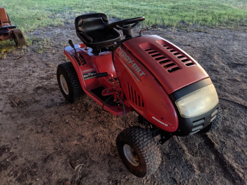

My daughter has had a lot of fun with this tractor.  I was hoping both daughters would dig it so I painted it purple.
Fast forward to last summer, I basically had an almost identical tractor fall into my lap, minus an engine.
2005 Troy Bilt Bronco.  Same setup, so there won't be anything to relearn.  I will however install an opposed twin. I was hoping for a 12-17hp single, but I have a 16hp opposed I can drop into it.  Daughter is wanting it to be yellow with green and orange accents.  I think I can make it look good.
The new ride..
Mighty's Daughter Build Img_2234
Mighty's Daughter Build Img_2235

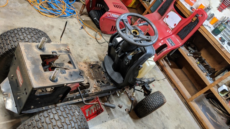

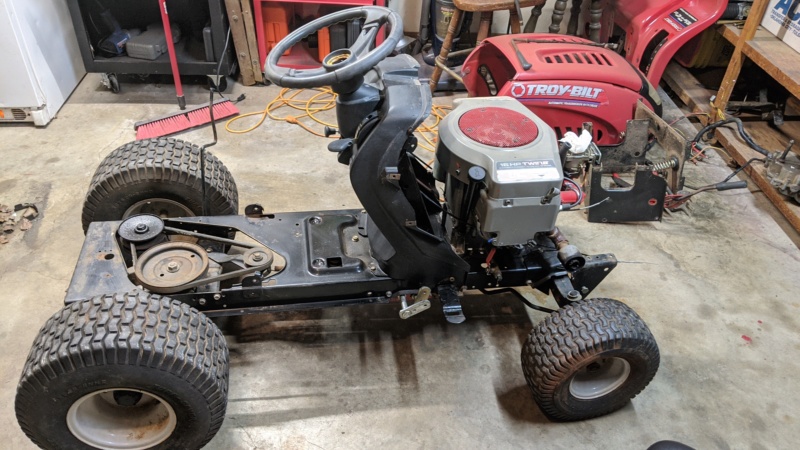

Tonight, I have started tear down.
Mighty's Daughter Build Img_2236
Impressed the bolts are already grade 8 it appears.  Much better built than the 2001. This thing has a HUGE gas tank on it.  Should work well with an oppy!
Plans: (Going to Keep it SIMPLE)
Tear it down to frame, clean and repaint.
Pulley swap the FNR down a couple inches.  I think that will be fine.
Cut a larger hole for the engine pulley.  Do about a 5-6 inch engine pulley.  Not looking for mondo speed.
Change tires to more aggressive.
Need to change one or two drive pulleys.

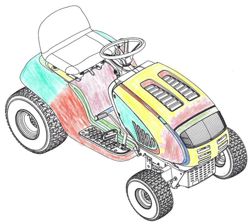

My Initial thought....
Mighty's Daughter Build Iz11
But you got me thinking...
Also, this drawing isn't the right model, the actual one has some good body lines to work with.

Had the daughter sit down and color a version.  I went ahead and digitized that.  I think we have an interesting paint scheme.
Mighty's Daughter Build Iz12

She wanted to go more colorful.... I had to step in and say, I may be able to paint well, but that is a little more than I can do.  LOL
Here was her first stab at it.  Smile

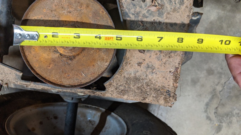

Would you mind getting me a picture of the clutch pulleys underneath?
Ive got a maybe newer one that needed a belt. Got the right belt and its too big... Im wondering if maybe someone put the wrong pulley in there somewhere. Parts diagrams list 2 different pulleys... that doesnt really make a whole lot of sense.
Age : 47
Points : 13123
Posts : 9290
Mighty's Daughter Build Empty
PostSubject: Re: Mighty's Daughter Build   Mighty's Daughter Build Icon_minitimeDecember 8th 2019, 3:24 pm
I've got 2 of these.  I'll take a pic of both.  This one does not have a belt on.  The other does.

@TheBeal
Here are a few pix of the 2 tractors.  Both the same.
Mighty's Daughter Build Img_2239
Mighty's Daughter Build Img_2238
Mighty's Daughter Build Img_2237

Thanks Mighty. Looks like what I have. I wonder, could I have gotten a mis labeled belt.
Age : 47
Points : 13123
Posts : 9290
PostSubject: Re: Mighty's Daughter Build   Mighty's Daughter Build Icon_minitimeDecember 8th 2019, 5:00 pm
It a husky from TSC?  Possibly. I have to measure every belt I get regardless.  I showed a worker there once.  Pulled out 3 1/2x88 belts.  One measured 89.5, one measured 87, and the third measured 96.  The worker was shocked.
Mighty's Daughter Build Sig110Tractors:
Mighty's Daughter Build Sig210Mighty's Daughter Build Sig310
Points : 5068
Posts : 1369
PostSubject: Re: Mighty's Daughter Build   Mighty's Daughter Build Icon_minitimeDecember 8th 2019, 5:17 pm
Genuine troy bilt belt. I cant think of any other reason it wouldnt work, just if the belt is wrong, or the pulley is wrong.
Its pretty clear it only goes on 1 way.
{EDIT} Would you be able to measure the rear pulley?
Age : 47
Points : 13123
Posts : 9290
PostSubject: Re: Mighty's Daughter Build   Mighty's Daughter Build Icon_minitimeDecember 8th 2019, 9:13 pm
Good documenting for the thread. @TheBeal
OK, Tension pulley is 3 inches like the clutch on both of my machines.
Mighty's Daughter Build Img_2240
Varidrive pulley is the same on both. 4.75 outer.
Mighty's Daughter Build Img_2241
Here is the difference...
2005 TB Bronco tractor is 7.25 outer
Mighty's Daughter Build Img_2242
Mighty's Daughter Build Img_2243
The 2001 TB tractor has a 8.5 outer pulley.
Mighty's Daughter Build Img_2244
Mighty's Daughter Build Img_2245
Hope those help!

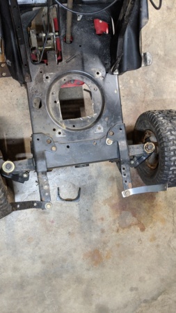

Little bit of trimming and fitment tonight....
Mighty's Daughter Build Img_2247
Mighty's Daughter Build Img_2246
Good thing I am not going too agressive with an engine pulley. Not much room for a larger one. I think I could trim that plate as well if needed.
