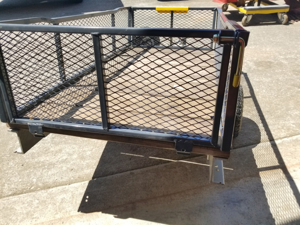

So we've had these sides to a 4 wheel cart (like the ones you see at flower shops and stuff) laying around for awhile and turns out they fit this trailer almost perfectly. Dad got them from some guy at work who made a welding cart out of it so he didnt need the sides. Says gorilla carts on it so look it up if your curious.
I just drilled holes in the side of them and used some wood screws with the hex heads to hold them on.

One neat thing is that the sides all latch together so you can always take it apart.
Only issue is that I dont want to bolt the tailgate down so that I can remove it if needed. So I need to figure out a way to keep it from flopping around.

So I thought about it for awhile and I thought about using hitch pins with rods, then I thought about just one big pin, then I thought about hinges. But all of that was just too complicated so I went with the kiss method! (keep it simple stupid)
So I found these wrenches that you get when you buy things that need to be assembled. Let's be honest who really uses the wrenches it comes with anyways???
Then I copied the bend it already had in it on the other side.
Then with some nuts as spacers I had some holder inner things so my tailgate doesn't fall off!
