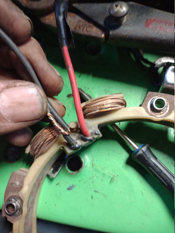

PostSubject: Re: Just wondering    Just wondering  Icon_minitimeOctober 29th 2023, 8:18 pm
Migtyraze I changed the flywheel fan an the bolt holes is the same but I was wondering if the are the same or would I have to change it all for push button start and toggle kill switch.Just wondering  Img_2083
Just wondering  Img_2084 as shown in the pic

PostSubject: Re: Just wondering    Just wondering  Icon_minitimeOctober 29th 2023, 10:02 pm
If wired correctly a push button start and toggle for the kill should not matter for the charging system.

PostSubject: Re: Just wondering    Just wondering  Icon_minitimeOctober 29th 2023, 10:52 pm
Thanks migtyraze the diode was cut of the other stator and the on e pictured has the diode. Still attached to the red wired but the black wire was an I rewired it .with a same color wire as shown
