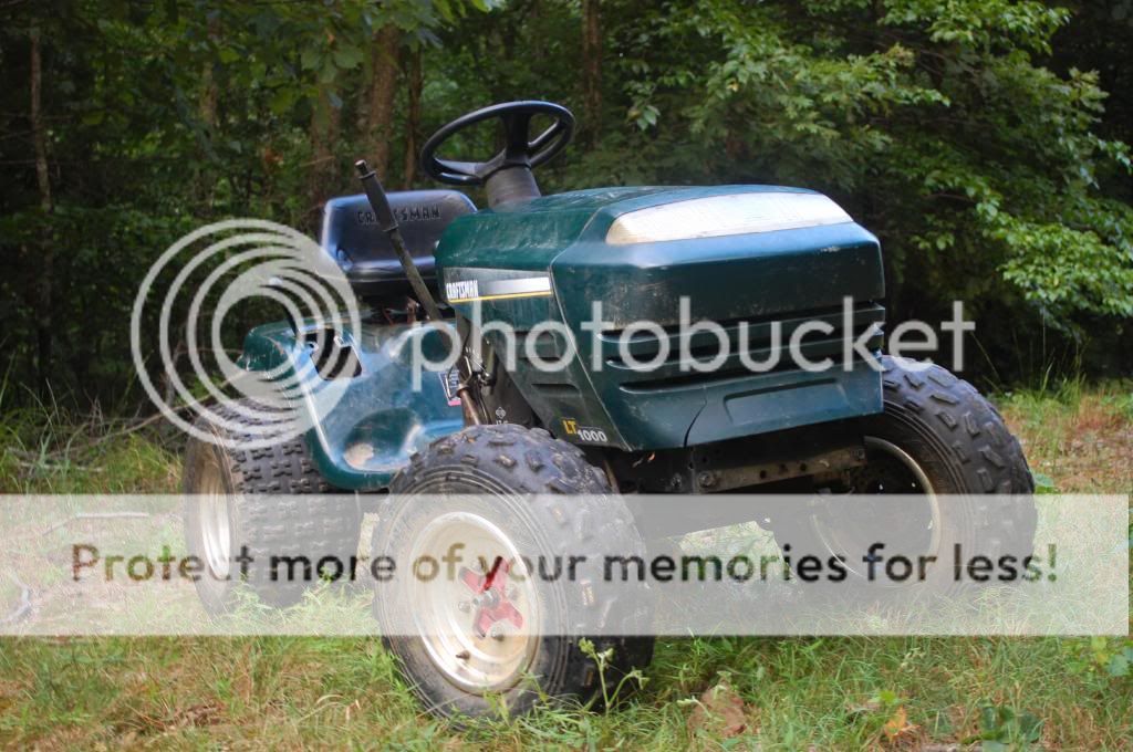

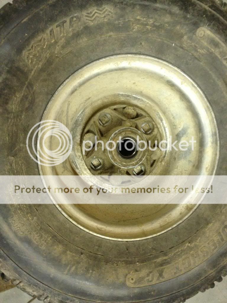

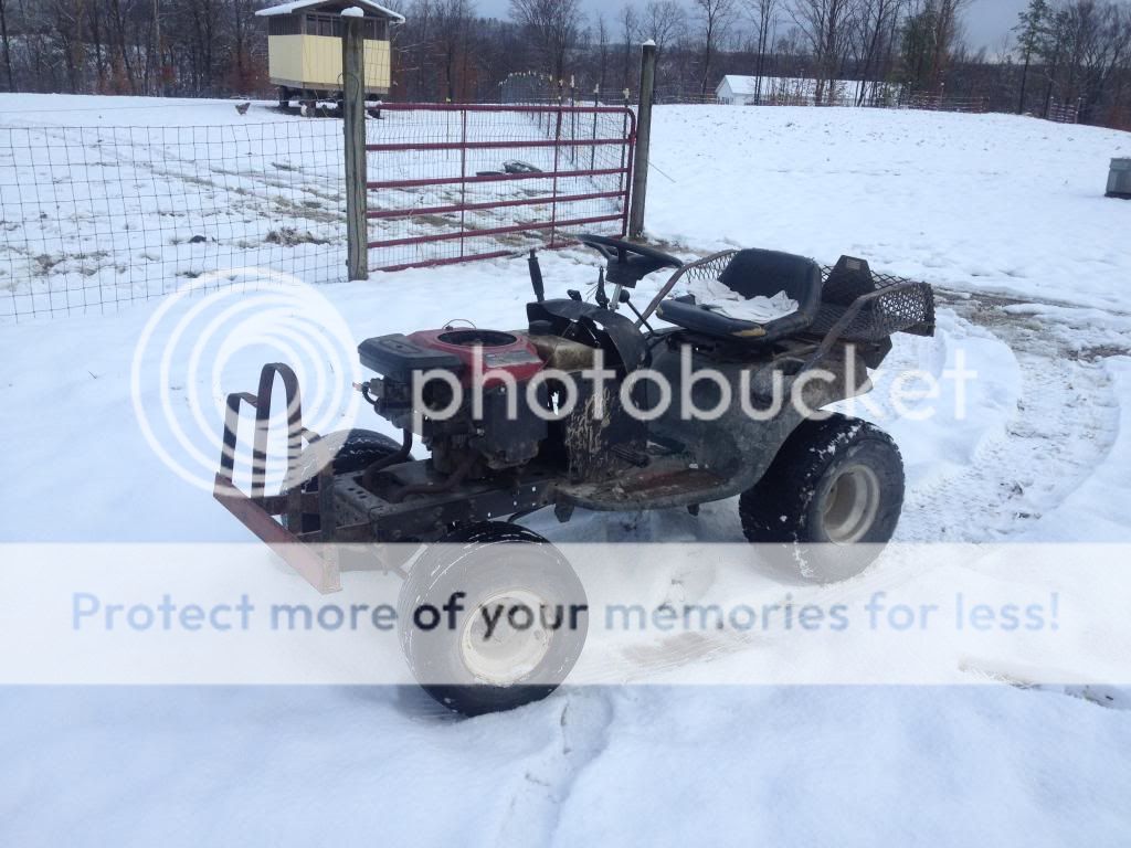

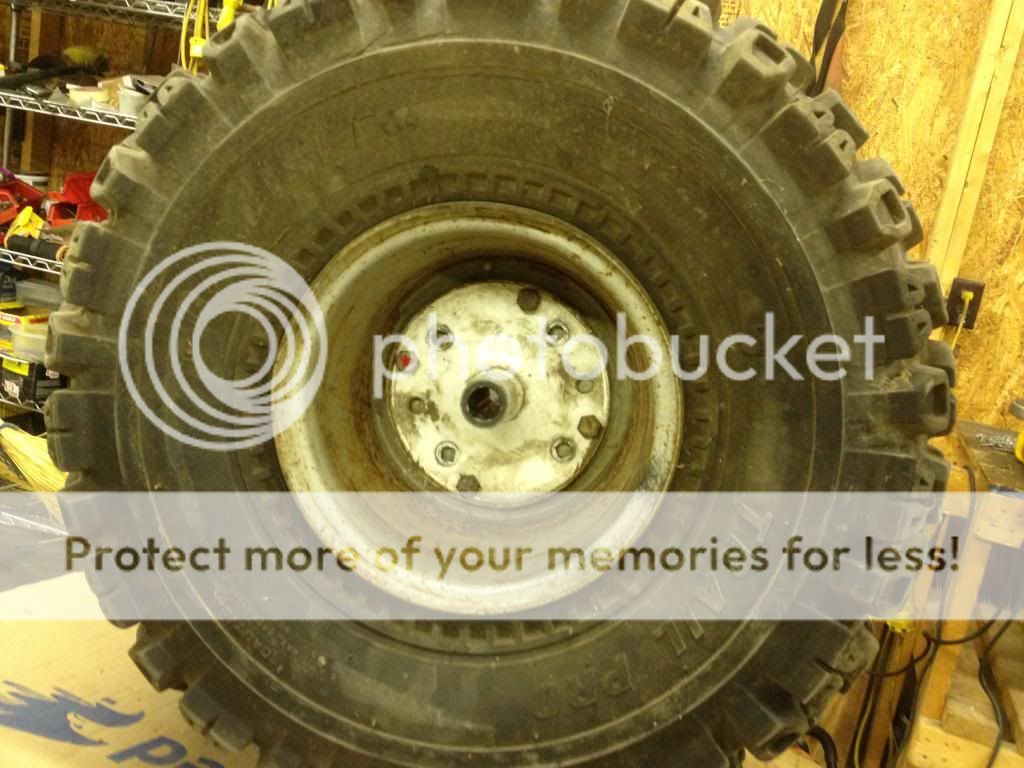

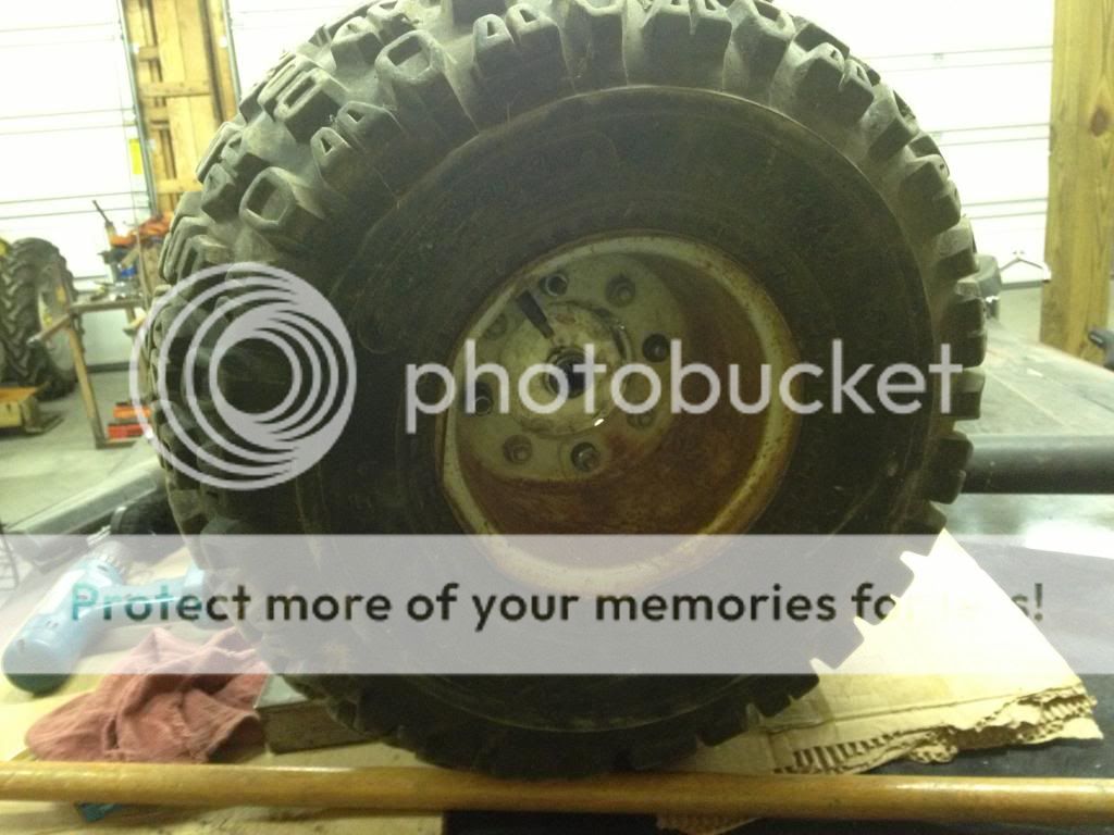

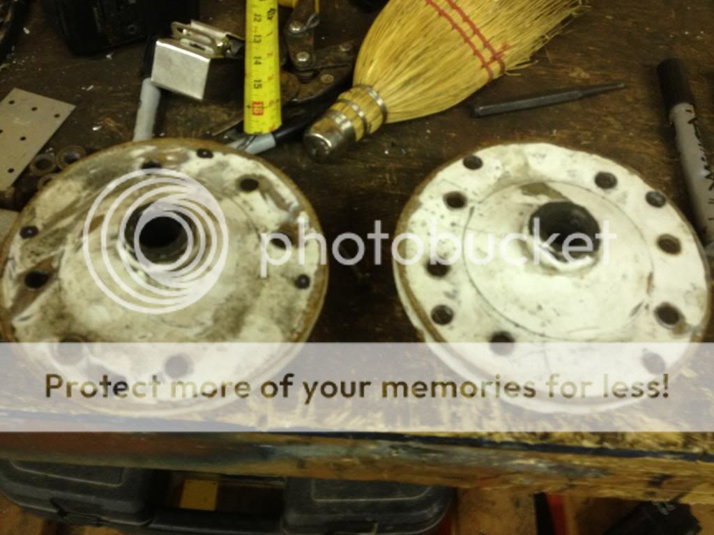

| Subject: Re: TMJ's Craftsman LT1000 Conversion Thread August 18th 2013, 10:39 pm | |
| About 45 min east of richmond and 8 miles west of West Point. Come on over sometime if your in the area. Ok folks, here is the current look and a sneak peak of what to expect. A while back, I bought a 86 honda TRX 125 for $50 bucks. It is missing some parts however, so till I get the money to get the parts, I borrowed the huge knobby rear tires for use as my new rear tires on Butch. Instead of using those no count golf cart tires, I decided to use the old rear tires on the front. Problem was, both the old set of rears and the 125's rear tires had different bolt patterns. Worse yet, the golf cart hubs also had different patterns too, so what to do? After looking at the golf cart hubs, I found I was able to make another set of four holes that would fit the old set of rear wheels.(From an 87 TRX 250x) The pics will show what I did.
Now for the back tires, IT was a matter of drilling a new set of four holes in the spindle to fit the 125 rears. Pics will explain.
Now this makes a problem in itself. The rears now are sucked in while the fronts are stuck way out. I'll have to extend the rear axles a little. This will involve making supports to avoid snapping the transaxle. This will be made using two idler pulleys with a 3/4" bore. For later though. As it stands, it is drivable, but silly looking. I am having an issue getting my engine to run. Issue started with a bad float. Soldered it and it no longer leaks. Still no go. Fuel just gushed out the top of the carb. Once running, it will start bogging down with black smoke. I'll shut off the fuel and it will smooth out but will just flood out the carb upon opening the feul valve again. I know the float is working so any help will help. | |

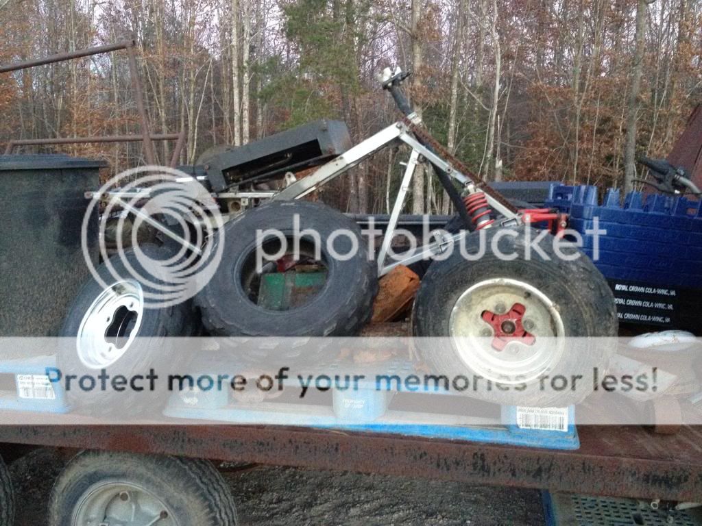

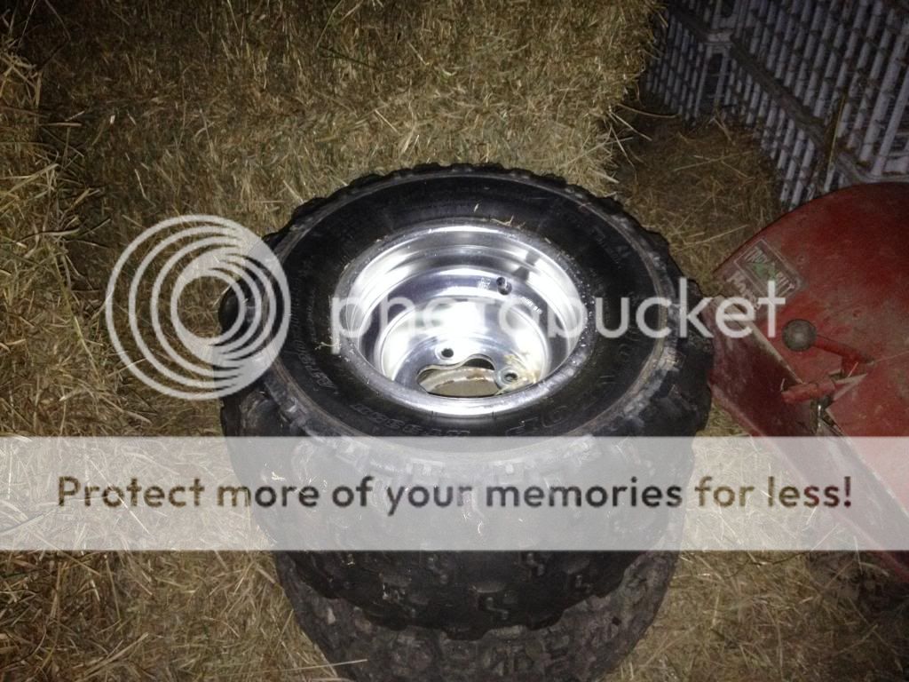

| Subject: Re: TMJ's Craftsman LT1000 Conversion Thread November 24th 2013, 4:46 pm | |
| Hey guys, this project is still going strong. Lack of funds have made work slow. Still trying to find a transaxle. I stumbled on a smokin deal on another set of honda ATV wheels. 4 tires and 3 aluminum rims. Two rear rims and tires, and two front tires with one bent up front rim. All tires are mint with great tread. The rears are for butch. The front tires will go on the 87 TRX 250 parts ATV that has two good front rims. That will be a future project. Also got a set of TRX 125 wheels to do stuff with.(rears are in the pics above) Pics will come later this evening. | |

Depending on how bad that one rim is, you might be able to fix it or run a tube. Head Forum Administrator ** Chat Moderator ** Facebook Page AdminATLTF Facebook Page ** Chatbox ** How To Upload Pictures
