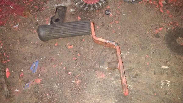

Got some pics.
Brake pedal:
Before
'86 Westwood T1200 - Page 5 M3Pik
After
'86 Westwood T1200 - Page 5 Img_2058
'86 Westwood T1200 - Page 5 Img_2060
'86 Westwood T1200 - Page 5 Img_2059

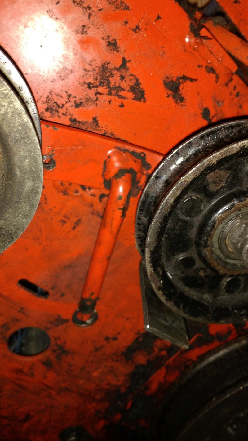

Next thing is the clutch.
'86 Westwood T1200 - Page 5 Img_2064
In the normal configuration, the orange rod connects to the clutch/brake pedal;
'86 Westwood T1200 - Page 5 Img_2061
I plan on turning the clutch around so the orange rod faces the other way, then have a clutch shaft running from the left side of the mowchine which pushes the clutch in and out. Make sense? Lol. I'll be doing the real thing soon so you'll see how it works.

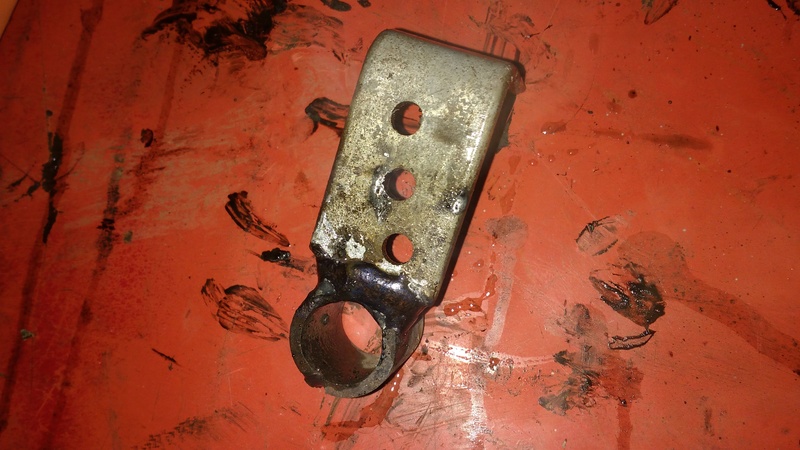

Here's this weeks progress;
Clutch:
Welded up a custom clutch pedal. Made from a Rally clutch pedal and Westwood brake pedal.

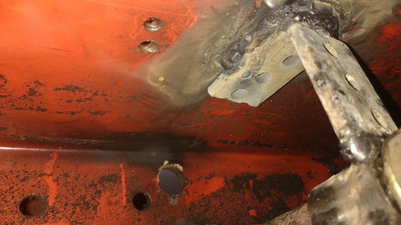

Welded in clutch support no. 1. This is part of a Westwood shifter.
'86 Westwood T1200 - Page 5 Img_2074

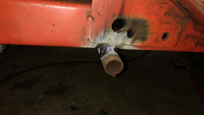

Clutch support no. 2.
'86 Westwood T1200 - Page 5 Img_2077
'86 Westwood T1200 - Page 5 Img_2079
'86 Westwood T1200 - Page 5 Img_2088
Clutch pedal installed

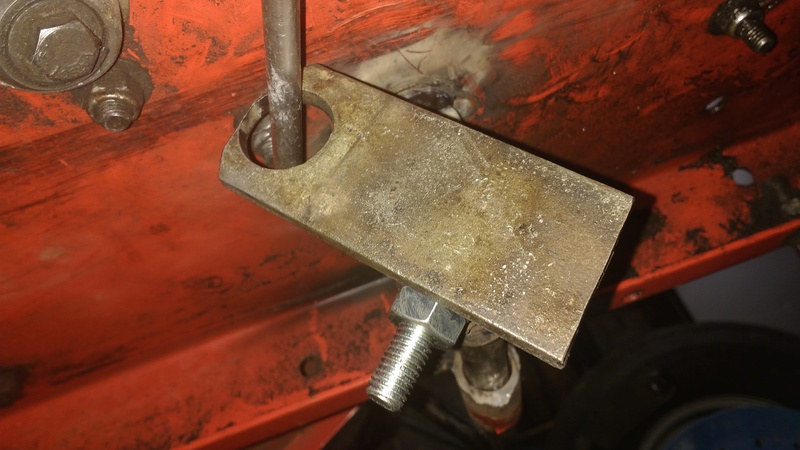

Now for the clutch engager piece thingy Very Happy
This is just a nut welded to a piece of flat steel with a hole in the top. I had to make several versions of this, but this is the final one that works reasonably well.
'86 Westwood T1200 - Page 5 Img_2089
'86 Westwood T1200 - Page 5 Img_2091
Cross drilled the shaft and nut to run an M10 bolt through. Hole is (now) 10mm. Was 6mm when that photo was taken.

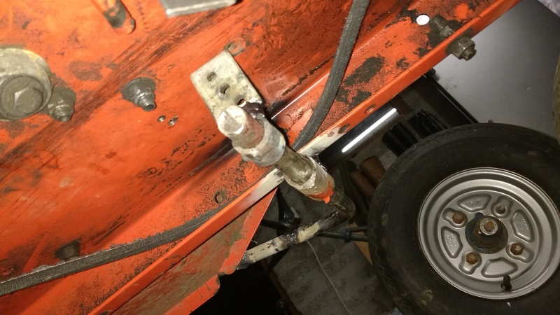

Modified clutch, longer rod that faces the opposite way from the previous one.
'86 Westwood T1200 - Page 5 Img_2084

Made a modification to the 'clutch engager'. This makes it closer to the clutch so less clutch pedal movement engages and disengages the clutch.

Box of transaxle parts.
'86 Westwood T1200 - Page 5 Img_2095
'86 Westwood T1200 - Page 5 Img_2097
'86 Westwood T1200 - Page 5 Img_2096
One of the roller bearings is destroyed and there appears to be no shifter balls. I have to take the other 801 I have apart to get those parts out of it.

PostSubject: Re: '86 Westwood T1200   '86 Westwood T1200 - Page 5 Icon_minitimeMarch 11th 2017, 10:37 pm
First time I took my trans-axle apart the snifter ball had rusted itself to the bottom of the spring and set screw.
