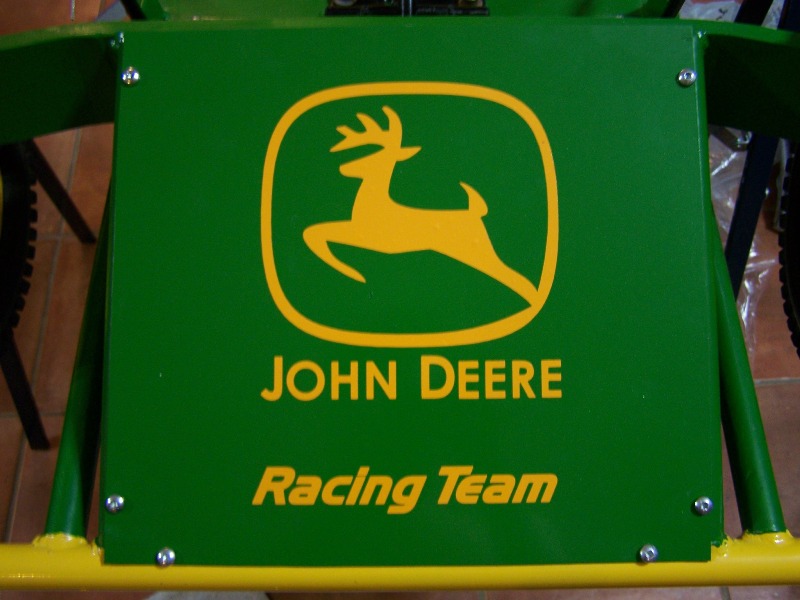

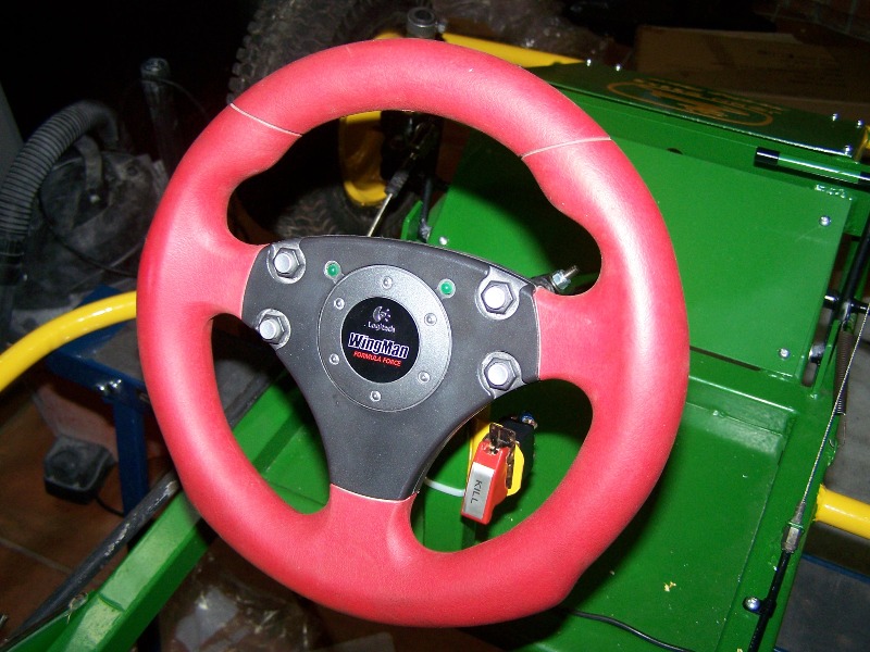

| Hey fellas! After touching on this topic in another thread, I thought I'd highlight it here. Though I'm new to the lawn tractor world, the go kart stuff is my bag- and closely related. I'll answer any questions you may have, but here's the short version- The frame is completely scratchbuilt from recovered scrap steel. The rear wheels, tires, axle and differential are from an old lawn tractor. From the same lawn tractor came the front axle beam, spindles, steering rack, and wheels. Front tires are from a gardening wagon. Couple tie rods ends from an old ATV. Steering wheel from a Microsoft Wingman Force Feedback game controller. The jackshaft and bearings are from an industrial ventilation fan. I bought the 4hp Kohler clone new from Princess Auto, and the Comet centrifugal clutch. A couple of the sprockets are new, and the yellow vinyl I upholstered it with came from Fabricland. The brake master cylinder, hose, and caliper came from a 1989 Yamaha Virago 250 motorcycle. I had the John Deere graphics made at a vinyl cutting place. With careful shopping, scavenging, and recycling, I only put about $200 into it.     | |

| - motorizedeverything wrote:
- do u know how fast it is
Of course i do- I'm totally anal about doing my homework. I geared it deliberately for 21 Km/h (13MPH) to start with, so the kids could learn without killing themselves. After they got used to it, we changed sprockets and then ultimately yanked the governor. Top speed went from 21Km/h to 52Km/h (33MPH). I got lucky with the steering wheel- it actually had a steel column inside so I was able to weld it to a boss on the steering column. It's very solid.

 | Subject: Re: Homebuilt Go Kart May 29th 2013, 8:56 pm | |
| - Doc Sprocket wrote:
- Thanks for the props, fellas!
I wonder if properly rewired, that the switches could act as a kill switch and/or start button? |
|  | | Doc Sprocket Administrator
1st Place 2016
1st Place Winner 2016
Age : 49 Join date : 2013-04-21 Points : 6657 Posts : 2914 Location : Ontario Canada
 | Subject: Re: Homebuilt Go Kart May 29th 2013, 9:17 pm | |
| I DID think about that. Start button would be easy, but being that they are all momentary switches, you can't use them for ignition on/off, or kill, lights etc- without using a latching relay (although it IS an option). | |
|  | | Guest Guest
 | Subject: Re: Homebuilt Go Kart May 29th 2013, 9:57 pm | |
- I DID think about that. Start button would be easy, but being that they are all momentary switches, you can't use them for ignition on/off, or kill, lights etc- without using a latching relay (although it IS an option).
Well sir, I will try it and let you know  I don't see why they would not work for it either... |
