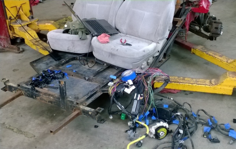

| #1 Priority was painting the valve cover red because racecar.  #2 Priority was stripping out the wiring harness which is now also done. Waiting on a ECU pinout so we can start yanking all the crud that isn't necessary.  _______________________________________________ - Quote :

| UGH.  On the topic of wiring though, yay!  I'm also using a Arduino board as a TCU so paddle shifters are soon to come. Moving over to the topic of steering, I started cutting up the car that's donating its front subframe, lots of fun.   _______________________________________________ - Quote :
