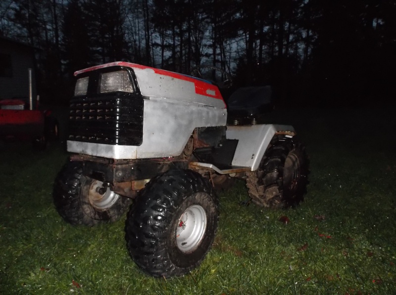

PostSubject: Re: Craftsman GT utility build "S.S. Stump"   Craftsman GT utility build "S.S. Stump" Icon_minitimeDecember 5th 2015, 9:37 am
got the bearclaws on. I hate it when I get home from school after dark. Craftsman GT utility build "S.S. Stump" 00310

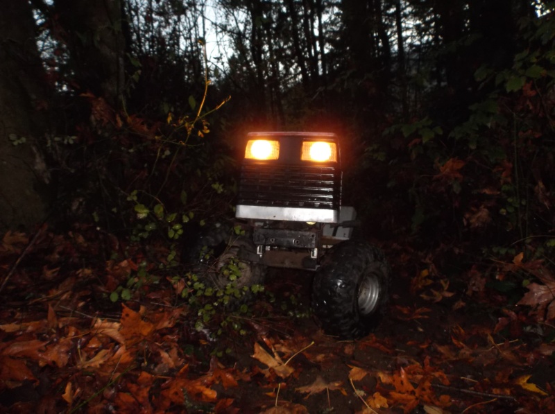

And a little romp in the woods.
Craftsman GT utility build "S.S. Stump" 02610
