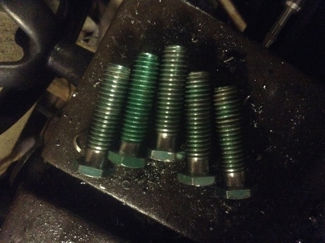

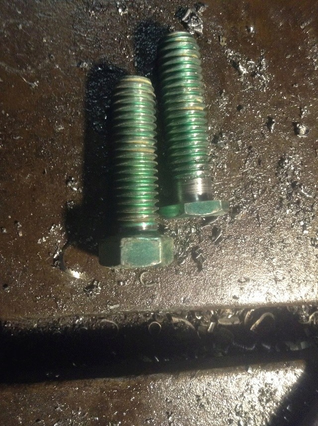

| Ak you party pooper. So to the lathe!  Before and after  A while later....  Beautiful.  | |

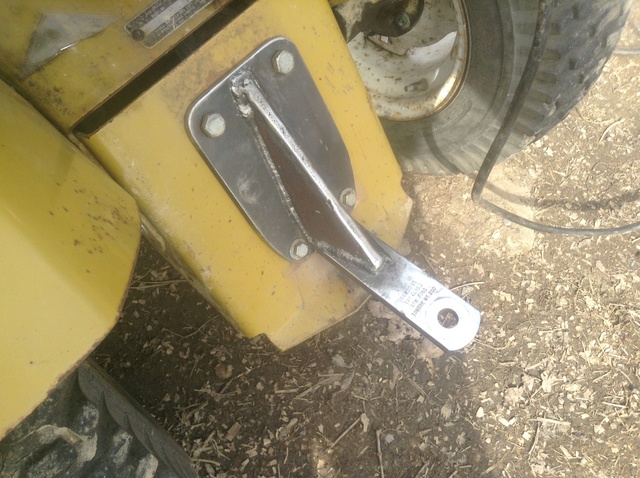

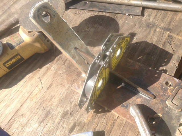

| You know, you look at these tractors, the hitch hole is always egged out and looks like poop. on these sears with 3/16-1/4in plate for the hitch. So I welded up a beefy hitch for the sears tractors today. It bolt into the existing holes in the frame. This will NOT egg out.   These magnets actually hold, and hold well. If anyone is in the market for some GOOD welding magnets these are excellent.  Weldzzz.... Didnt need this many here, but I needed the practice.  Chunk of 1/4 for the brace. Looks kinda dumb all by itself...  Trying some fancy angled pieces. Looks cool!  Not my prettiest welds ever, I am out of practice.   ...but in the end, I guess it will look alright with some paint. | |
 | Subject: Re: Some sort of craftsman... and more! March 19th 2018, 8:58 pm | |
| Great heavy duty draw bar Beal! Should be able to put some wicked weight on that no problem now. _______________________________________________ "This'll either wake you up or put you to sleep forever!"- Red Green "Whatever you do you should do right, even if it's something wrong." - Hank Hill - MTD Off-Road Build - Ford LT 110 Off-Road Build - Craftsman GT 6000 Off-Road Build - Sears LT11 Rat Rod Build *2019 Build-Off Winner!* - Allis B-110 x2, 710 & 716 - Wheel Horse 655, 953 & 500 Special - Case 444 - Bolens Versamatic & 1668 - Cub 106 & 124 - Ford LGT 125 & 145 - White 1650 Yard Boss | |

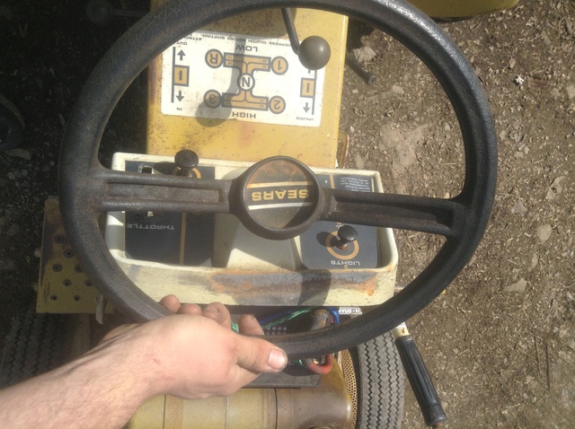

| Yeah, it will handle weight the tractor couldn't dream of pulling. Havnt figured out the carb issues on the ST10 yet Buck... the o-ring in the bottom adjustment needle deteriorated. and was leaking. Need to find a replacement. As I was moving it, the steering wheel finally gave out. Itd been loose for a while.   Well thats no good...   So i cut off the rubber and slapped some booger welds on it. If I was smarter at the time, I would have taken more time and cut the rubber off in such a way it could slip back on and be glued together... ohwell. | |
 | Subject: Re: Some sort of craftsman... and more! March 20th 2018, 12:03 pm | |
| The steering wheel on my little LT 11 is that same two spoke one and it's broken in the same way. I didn't know if it was a common thing or if the previous owner was just a hardcore grass cutter, haha. _______________________________________________ "This'll either wake you up or put you to sleep forever!"- Red Green "Whatever you do you should do right, even if it's something wrong." - Hank Hill - MTD Off-Road Build - Ford LT 110 Off-Road Build - Craftsman GT 6000 Off-Road Build - Sears LT11 Rat Rod Build *2019 Build-Off Winner!* - Allis B-110 x2, 710 & 716 - Wheel Horse 655, 953 & 500 Special - Case 444 - Bolens Versamatic & 1668 - Cub 106 & 124 - Ford LGT 125 & 145 - White 1650 Yard Boss | |

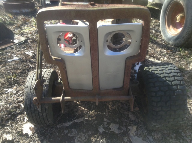

| ehhhh....   Not sure how I feel about this... | |
 | Subject: Re: Some sort of craftsman... and more! March 24th 2018, 10:10 pm | |
| I remembered seeing the picture of this tractor. I thought you were going to park it in the weeds and use it for parts lol. Nice to see you dress up the ole girl. | |
CraftsmanQuad19 Core Member
 | Subject: Re: Some sort of craftsman... and more! March 24th 2018, 10:20 pm | |
| I dig it Beal. Looks really good. Looks like a resto-mod hood | |
