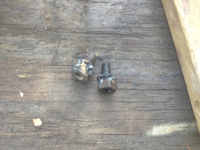

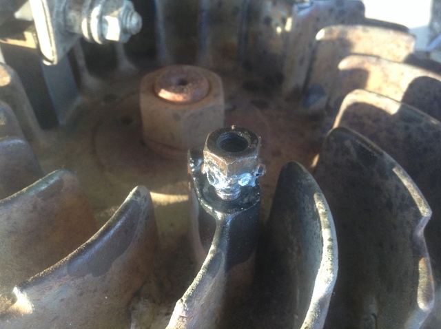

| So, on another note. Got a broken off bolt? This method works good if its broken off above the surface. 1/4-20 bolt. Thin washer just needs a couple hot tack otherwise it will burn up.  A sacrifice is required. I chose a nylon lock nut. After a couple tacks the nylon is all burnt out. Dont breathe it in.  Tacking it on all sides, leaving enough to get a wrench on. Whack it with a hammer, spray some penetrating oil on em.  Seems to work. | |

| Nice job on the extraction beal. What they did at the shop that put a new manifold in my truck was weld a bunch of hot tacks on top of the broken off stud to make a booger which they grabbed with vise grips. | |

| And the heat from the welds help break the rust. _______________________________________________ Tractors: Li'l Red - 89 Murray Widebody TheGreenMachine - 89 Craftsman GT18 Bowser - 01 Murray Widebody LT Phoenix - 75 Sears ST/16 Dirty Rat - 77 Sears Suburban Kal-El - 82 Murray GT Have a question? Ask me! Type in "@MightyRaze" in your post! | |

| On the two case bolts that broke off in Mutt's second 820, I welded a nut to them, kept them hot with a torch, and then doused the whole operation with cold water. They turned right out then. | |

| Heating and cooling does wonders for getting rusted things loosened. So back on the ST10... brake works!  Now I dont have to use... trees and parked cars to stop! | |
