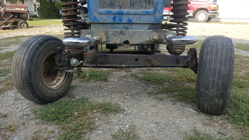

| Well I made some more progress on the Twin I-Beam setup today. First I braced the inside of the grille so the coilover mounts dont bend the steel.  I also drilled and tapped the ends of the beam pivots so they could be held tight in the knuckle.  And here's how she sits now!     I still have to finish up the radius arms/mounts and get the steering all working again, but that's another day's job haha. It bounces pretty good with this setup and I think she looks pretty mean with those coilovers on there! Let me know what you think! _______________________________________________ "This'll either wake you up or put you to sleep forever!"- Red Green "Whatever you do you should do right, even if it's something wrong." - Hank Hill - MTD Off-Road Build - Ford LT 110 Off-Road Build - Craftsman GT 6000 Off-Road Build - Sears LT11 Rat Rod Build *2019 Build-Off Winner!* - Allis B-110 x2, 710 & 716 - Wheel Horse 655, 953 & 500 Special - Case 444 - Bolens Versamatic & 1668 - Cub 106 & 124 - Ford LGT 125 & 145 - White 1650 Yard Boss | |

 | Subject: Re: Ford LT 110 Off-Road Build September 17th 2017, 6:57 pm | |
| AH Yeah! That looks sweet! _______________________________________________ Tractors: Li'l Red - 89 Murray Widebody TheGreenMachine - 89 Craftsman GT18 Bowser - 01 Murray Widebody LT Phoenix - 75 Sears ST/16 Dirty Rat - 77 Sears Suburban Kal-El - 82 Murray GT Have a question? Ask me! Type in "@MightyRaze" in your post! | |
 | Subject: Re: Ford LT 110 Off-Road Build September 17th 2017, 9:38 pm | |
| Thanks mighty! Haha, she definitely looks pissed off with the grille and the big coilovers. _______________________________________________ "This'll either wake you up or put you to sleep forever!"- Red Green "Whatever you do you should do right, even if it's something wrong." - Hank Hill - MTD Off-Road Build - Ford LT 110 Off-Road Build - Craftsman GT 6000 Off-Road Build - Sears LT11 Rat Rod Build *2019 Build-Off Winner!* - Allis B-110 x2, 710 & 716 - Wheel Horse 655, 953 & 500 Special - Case 444 - Bolens Versamatic & 1668 - Cub 106 & 124 - Ford LGT 125 & 145 - White 1650 Yard Boss | |
