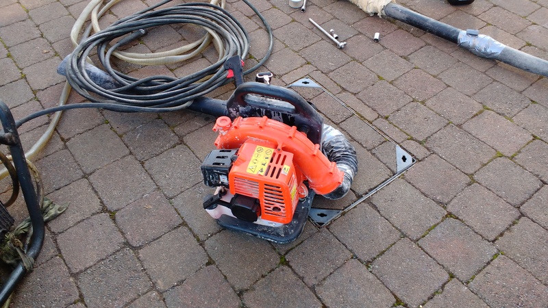

| Yup, I will clean it up. Probably not repaint it but we'll see. I need to replace the fan, it's plastic fins and are separate from the flywheel. On another note, got some free stuff today!  A Honda GX200 Power Washer  Chinese leaf blower  Stihl SR400 Leaf blower  They aren't in the best of shape. The leaf blowers have spent there lives blowing out hen houses. The red/orange leaf blower has a strange clank when you turn it over. Am thinking one of the blades has come loose/off. So I started work on the Stihl, seemed the most likely one to start. Put some fuel down the air inlet, and it started and ran for 2 seconds then stopped and would not restart. There is good compression, and I tried warming up a spark plug but still didn't restart. The spark is ok-ish but I'm thinking it may not be sparking under the compression. I'm going to clean all the mucky stuff off it and take the coil out, clean it, readjust it and try to see if it will run. The coil is at the back, so makes working on it hard. Both blowers came with fullish tanks of fuel which seems to be good. I put some in my hedge cutter and it ran fine. | |

| Make one of the leaf blowers into a turbocharger for the Westwood.  Nice finds man! I think that the Stihl shouldn't need much work, Stihl makes very reliable stuff. | |

| Bet it’s the diaphragm on the carb. Those go out on a small 2 stroke engine before anything else typically | |

| The Westwood is not getting turbo'd W  Turns out it was a spark problem, that and the engine was flooded from being repeatedly pulled over. I took off the coil, it and the flywheel were covered in a wet sludge muck of some kind, it must have been allowing some spark but not enough. Anyway, cleaned it all up with a cloth and some fuel. Set the gap, had a bit of a struggle trying to refit the earth and throttle cable clamp but I got it done eventually. Checked for spark and there it was pretty good, put her back together, there's a useful throttle lock to hold the throttle wide open, had to use that coz it was flooded. After a few pulls she fired up and runs quite well. The idle was too high so I turned it down a bit, I think the carb might need a bit of cleaning/adjusting but for now she's running well. There is quite a bit of power with this thing, blows stuff around quite a bit. There's also a tank on the top of the engine to put additive or cleaning fluid in. I'm probably not gonna ever use that so I may remove it.  | |

| Also had a wee look at that Chinese blower today, took the engine off took apart the blower housing to find out what the clanking noise was. I thought it was something in the blower chamber colliding with the fan but it turns out the bolts holding the fan were loose. This being a chinese copy, it didn't have a lock nut, just two normal ones. I didn't have a lock nut of that thread so I put them back on with some loctite and tightened them up.  Reassembled it and no more noise. Marvellous. I then tried to start it, but it wouldn't go. Checked for spark, and there is a little but not very much. Same story as the Stihl, likely some muck in there stopping a good spark being made. The only thing with this one is the coil is right at the back of the engine, next the blower housing so now I have to take the engine off again, remove the blower housing and fan to get at the coil. | |

| Two stroke oil mixed with all the dust these things blow around tends to do that. How does the plug look? Excessively oily? Good compression? | |

The plug is very wet, so it points to a spark problem. The compression is quite good actually, better than the Stihl to be honest. - prancstaman wrote:
