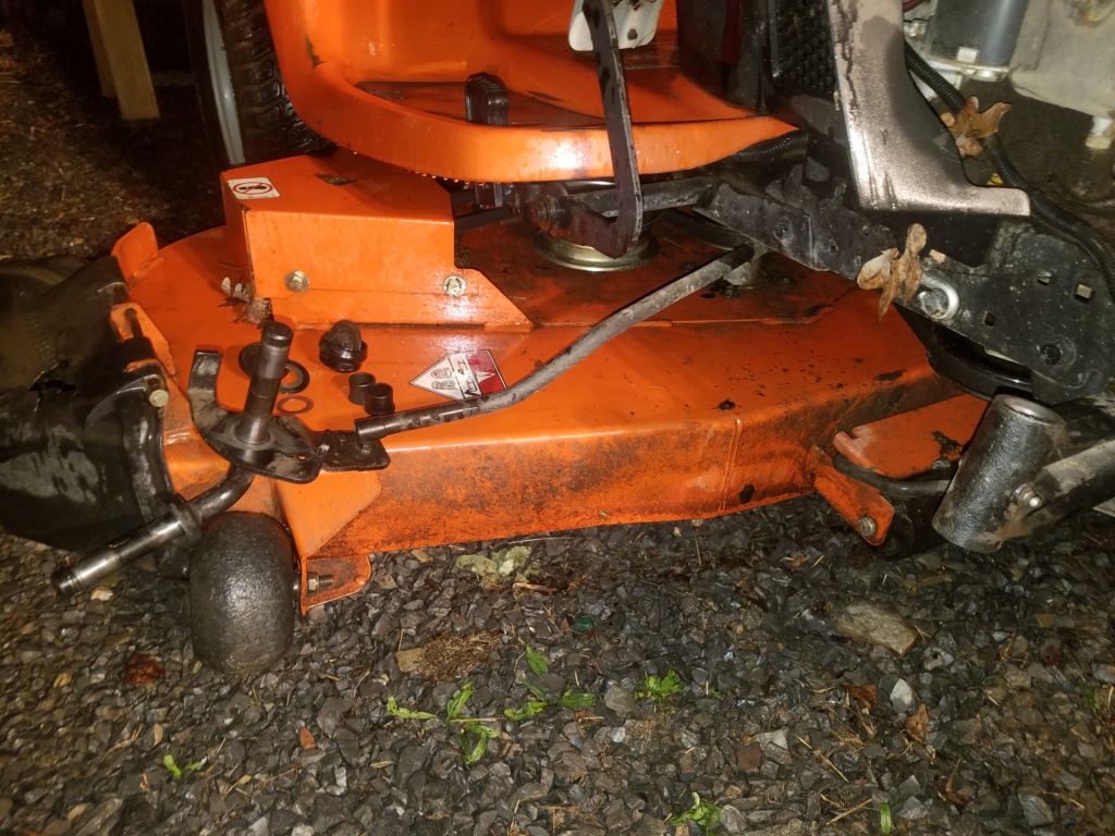

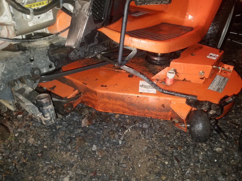

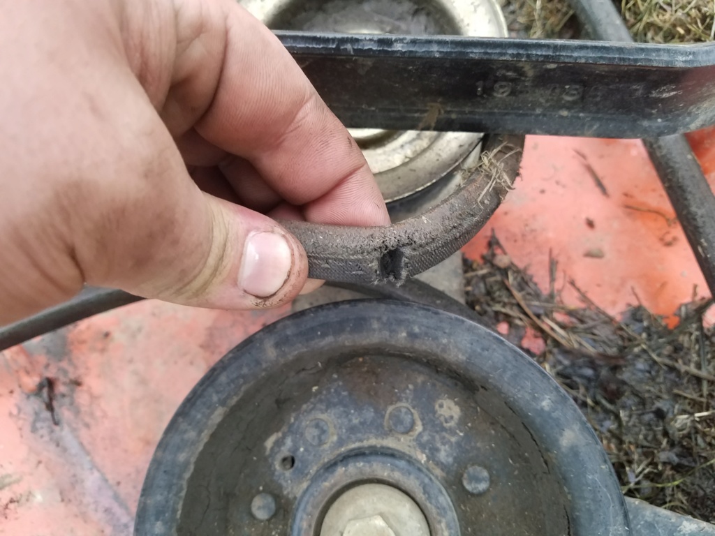

Been busy with this 2016 Husqvarna GTH 52XLS Garden Tractor. Did a full tune up & maintenance on this unit. It has 328 hours on it. Last year it cut 113 yards. It has a 24hp Briggs vtwin that wasn't purring like a kitten no more. The list goes on an on. Over the 4 years of owning it lots have broken on it. The rear differential actuator has broke, throttle snapped, deck flap Has Broken, seat has been damaged by Sun, muffler guard has snapped a couple places, front hood got bent in from a tree branch, plastic handles have been stripped out where the bolt goes so the flap around but they're still on the tractor, differential rocker switch has blown off, & lost count of how many blades and sharpen blades I've gone through. It has been a good tractor but I've done 10 years of mowing in three Summers. Its tired
- Plugged the two front tires.
- Disassemble front axle to replace axle/spindle washers that had grinded down and disintegrated.
- Replaced backing washers for the front rims that had grinded down to thin.
- Greezed front axle and rims.
- Unbolted and straightened up muffler guard.
- Oil change and installed new oil filter.
- Replaced plugs and blew out air filter.
- Topped off battery.
- Remove deck to pressure wash.
- Painted underside of deck and installed new blades.
- Grazed the deck hubs and tightened up idler pulley.
- I need to pick up a deck belt due to I came across a crack that is almost the full depth that I didn't notice before
- Washed the whole tractor

pretty heavy duty deck on that for being what it is, I have taken a few of them apart and dont remember the decks looking like that.
Points : 4014
Posts : 2120
JC's Small Engine Repair Shop  Empty
PostSubject: Re: JC's Small Engine Repair Shop    JC's Small Engine Repair Shop  Icon_minitimeMarch 31st 2020, 9:45 am
Oh yeah. Most of the locking diff ones have those fabricated decks.
the only thing I don't like about this deck is the little metal tabs where the wheels are. The factory forgot to weld the bottom of the tabs to the deck so there kinda pulled out and twisted which sucks. Other than that its well built.
Hillbilly Offroading
2019 Build-Off Entrant
1st Place Build-Off 2020
1st Place Build-Off Winner 2020
Join date : 2018-11-09
Points : 2490
Posts : 580
Location : Reeses Mill, WV
PostSubject: Re: JC's Small Engine Repair Shop    JC's Small Engine Repair Shop  Icon_minitimeMarch 31st 2020, 11:42 am
@Murraymountain Do you know what gage metal they are? Never thought about checking the thickness.
Points : 4014
Posts : 2120
PostSubject: Re: JC's Small Engine Repair Shop    JC's Small Engine Repair Shop  Icon_minitimeMarch 31st 2020, 3:31 pm
I'm not sure, but I think it's 12 gauge.
