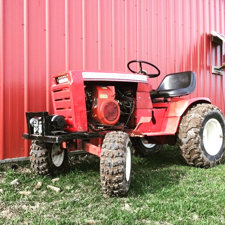

PostSubject: Re: “Ol’ Red” 1979 Wheel Horse C-81   “Ol’ Red” 1979 Wheel Horse C-81 - Page 18 Icon_minitimeApril 15th 2019, 11:51 am
I took Ol' Red to the farm for a short test and tune session.  2 gallons of washer fluid in each of the front tires is a huge success!  I can actually turn now instead of pushing the front end all over the place.  I could actually make the tight turns on my trail instead of having to backup like I had in the past.  This is huge for low speed crawling and handling.  I really like the gas pedal design too.
“Ol’ Red” 1979 Wheel Horse C-81 - Page 18 5a2bc310
Points : 8043
“Ol’ Red” 1979 Wheel Horse C-81 - Page 18 Empty
PostSubject: Re: “Ol’ Red” 1979 Wheel Horse C-81   “Ol’ Red” 1979 Wheel Horse C-81 - Page 18 Icon_minitimeApril 15th 2019, 11:53 am
She looks great Carl!! Sounds like you're really getting 'er tuned in for the trails!
