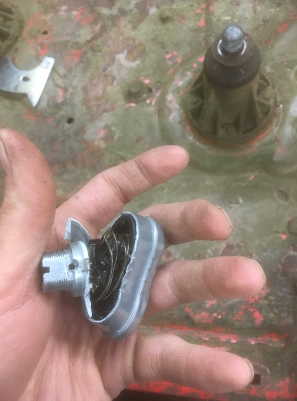

| I had a terrible night working on Ol' Red. I ordered a new $13 Oregon ignition switch from Ebay. I was teaching my girlfriend how to install it. When I turned the key on she saw a spark somewhere and the main fuse in the wiring harness going to the battery was blown. She thought it was something she did in the wiring but that was all fine. I replaced the fuse and the old corroded fuse holder, hooked up only the battery wire to the back of the ignition switch and the fuse blew again! Checked out the switch with an ohmmeter and turns out the battery terminal is shorted to the case which is ground! Instead of dealing with returning this in the mail or dealing with online customer service I decided to do this to get some anger out.  I crushed its soul with the vise. Turns out my intermittent starting problem is more likely caused by some loosely crimped homemade battery cables which I am going to either re-crimp at a place I know that has the right crimper or buy better battery cables. I think I'm just going to put in the old Ignition switch back in but I hate how the key is loose in the off position so it falls out easily. | |
 | Subject: Re: “Ol’ Red” 1979 Wheel Horse C-81 December 8th 2017, 10:32 pm | |
| I'd get an automotive or tractor type switch. Pretty easy to wire up, and have a decent detent(to hold the key in at least) and can't be turned by any idiot with a screwdriver. If you have the powered ignition you can wire the coil to the switch so when you turn the key off it looses power(like a normal tractor or car), or if you have a magneto like I do you'll have to get a relay so that when you cut off power to the relay, it grounds the ignition circuit, killing the engine. Warning: TSC switches get worn quickly, and can hang up, letting the starter stay on while the engine is running...not good for plastic starter gears! | |

| Rich If I ever go to Haspin or something like that I’ll put in a real keyswitch, and it won’t be a TSC one. I’m trying this solder fix on these homemade battery cables. Hopefully they won’t losen up anymore.  | |
