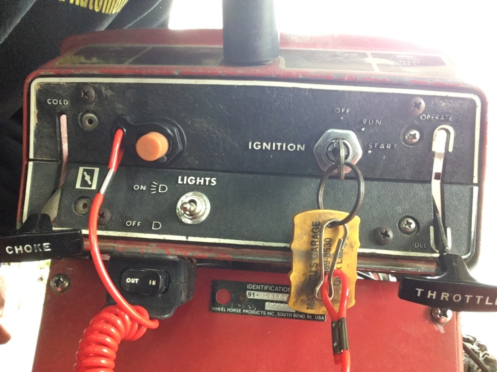

 | Subject: Re: “Ol’ Red” 1979 Wheel Horse C-81 May 14th 2019, 6:52 pm | |
| I took some time to wrench on Ol' Red today and it's ready to go to Haspin! I cringed at drilling into my dash and the forstner bit did wander but the hole came out in a great place for the tethered kill switch. All I had to do was move the igntion wire to it and run a jumper wire over the key switch. An added bonus of this is that I can pull the tether to kill power to the coil but still can have the key on to power accessories like the lights and winch.  I bolted the rear rack back on:  I replaced this john deere wide flanged idler on a customer's mower and thought it would be perfect to try on Ol' Red. So right now I've got my belt guard and floorboard off to start the engineering process to see if this one will fit and how it will effect the belt system. If it doesn't work out, I don't have a problem running the idler I currently have.  | |

 | Subject: Re: “Ol’ Red” 1979 Wheel Horse C-81 May 14th 2019, 10:12 pm | |
| Nice balance with the key switch on that tether kill! Ol' Red is looking good! I have tether kill on my Kal, but not my Li'l Red. I will look into that after Haspin. | |

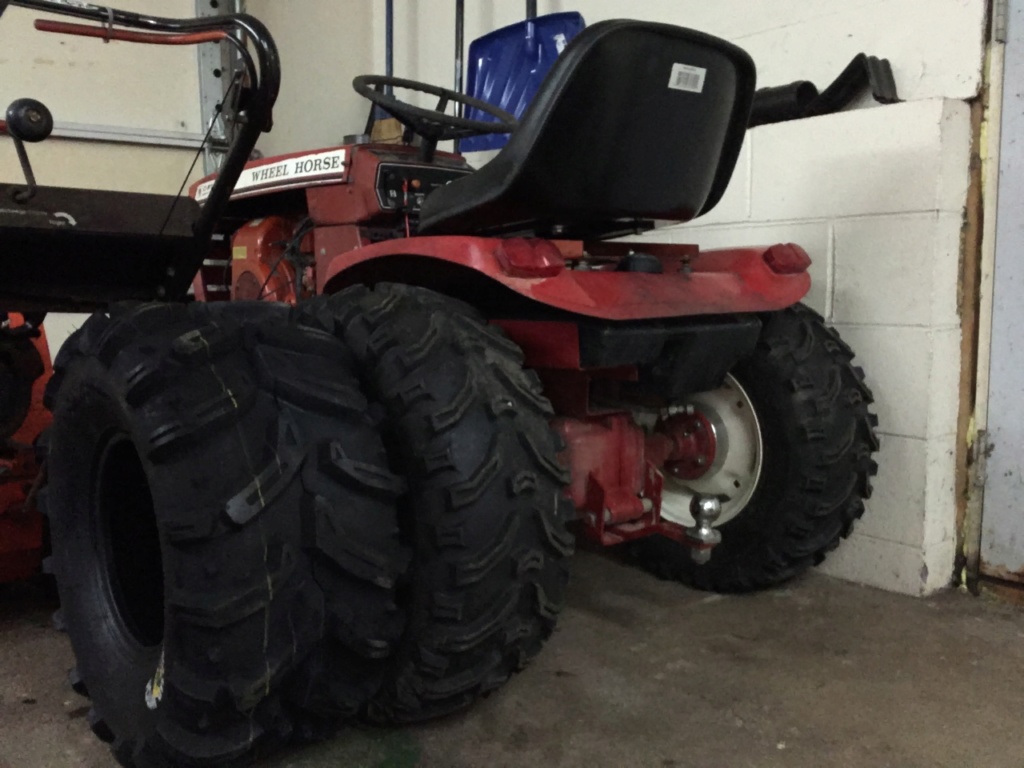

 | Subject: Re: “Ol’ Red” 1979 Wheel Horse C-81 December 6th 2019, 6:35 pm | |
| As some of you may have saw in one of Redzz02's videos I did roll the tractor onto myself. It was totally operator error and the tractor is fine. Pretty cool view of the bottom side of Ol' Red lol. I was running Redzz02's vampires. They really hooked well and the smaller diameter made a good positive difference in gearing. So I've bought a set of 24X11-10 Swamp Witches that need to go on before the next group ride. I'll need to source some used aluminum 10" atv rims and have them modified.  I would also like to work on my clutch not releasing as easy as I'd like it to, a better hood/dash connection, and weld up the locker. | |

 | Subject: Re: “Ol’ Red” 1979 Wheel Horse C-81 December 6th 2019, 7:38 pm | |
| You're still alive! Lol
Glad your nuts......er.... Ol'Red is ok. Nice tires. Maybe keep an eye out for 5 lug 4.5 circle trailer wheels too! But atv would prob be cheaper. | |

 | Subject: Re: “Ol’ Red” 1979 Wheel Horse C-81 January 10th 2020, 6:13 pm | |
| @Crazy_Carl seen the video, glad your ok. How did you like running the wider tires. It was the best thing I did on mine. Alot more stable | |

 | Subject: Re: “Ol’ Red” 1979 Wheel Horse C-81 January 14th 2020, 7:39 pm | |
| Oh yeah... look at that thick posterior..  | |
