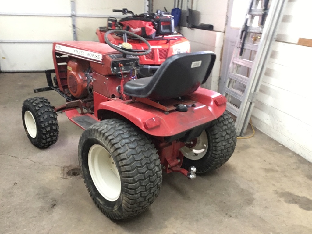

Today I took the rear tires in 3/4" on each side.  If it doesn't help the turning radius there's nothing wrong with being a little narrower to get through tight spots.

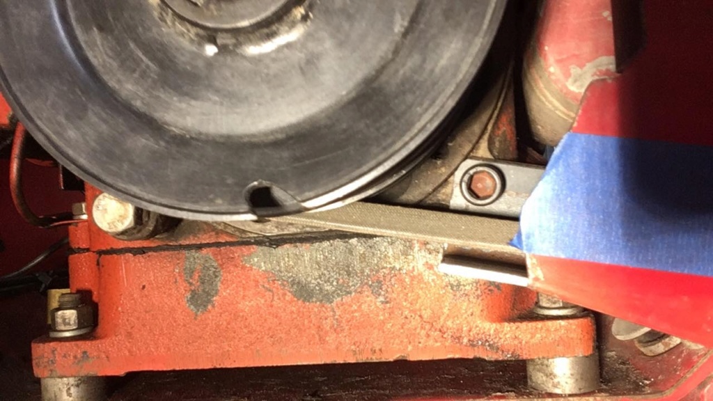

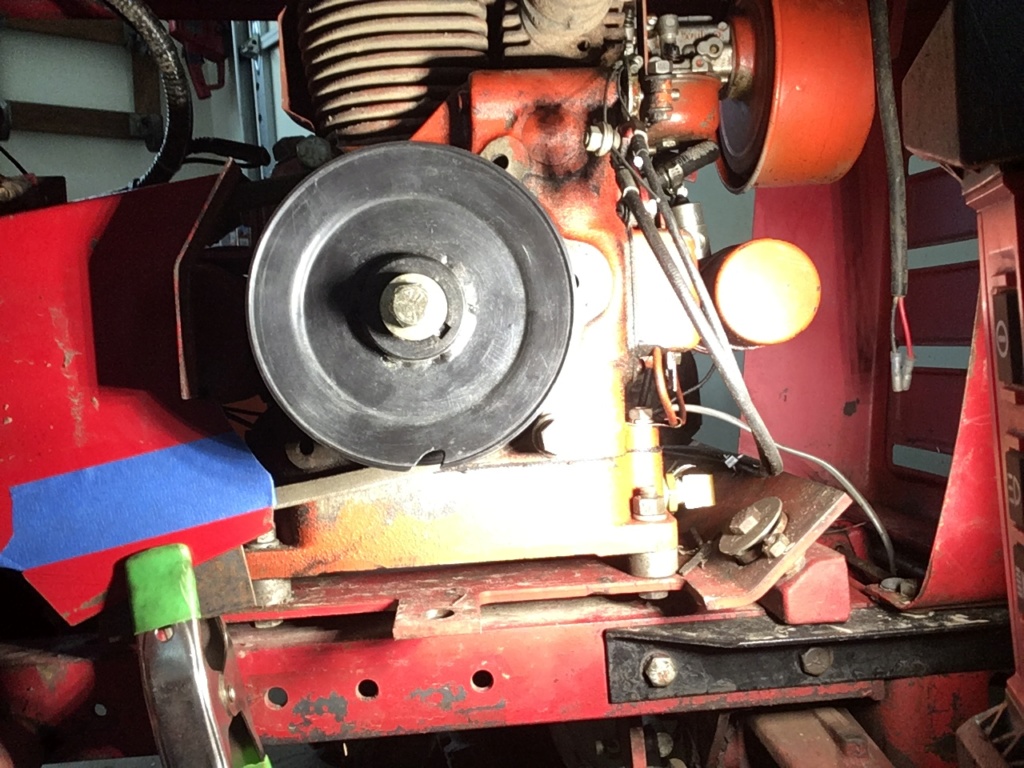

I'm looking for input on my next problem.  I'm experimenting with a belt guide to help the clutch release.  There was an important belt guide built into the factory clutch cover that I had to cut off to accomadate the bigger engine pulley.  So I'm thinking about putting a small adjustable angle iron belt guide in this location to help the problem.  I want to test it during the day tomorrow.

I bet that guide would help a lot to relieve belt tension on the pulley. Keep it from dangling low causing it to catch.

Yes it did help quite a lot.  I used @BlakeGroce 's technique using a screwdriver as a belt guide while someone is pushing in the clutch and it makes a huge difference.  I made an angle iron belt guide bolted to the engine with a socket head cap screw.  I'm also using a lighter clutch spring.  It makes shifting from the gears at a standstill a lot easier.  Up shifting from 2nd to third there is still a little bit of grinding

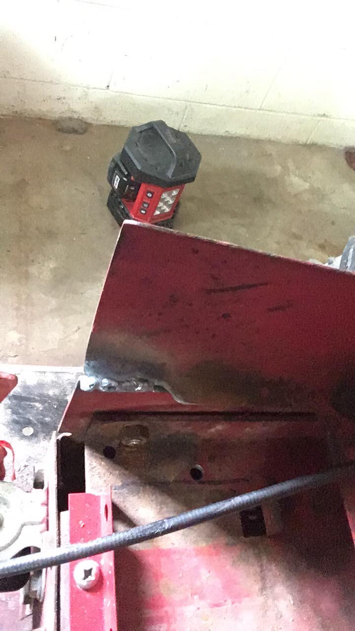

Pulling on the steering wheel is causing the dash to separate where it's not bolted together very well.  I added a little weld.  It should help the hood stay closed.  I also rigged up something with some bolts in existing body mount holes to make an official spot for the hood bungee to hook to.  Rig drives a lot better and it's pretty much ready for TTC2020, but with time on my hands I'm sure I'll do more maintenance and maybe some tweaks here and there.

Not sure how you would feel about hole or if you even have room for one.   I know you want to keep it looking mostly original.  This is a solution I did on my Li'l Red to keep the hood shut.

a hood pin or two could work I just can’t bring myself to drill the hood

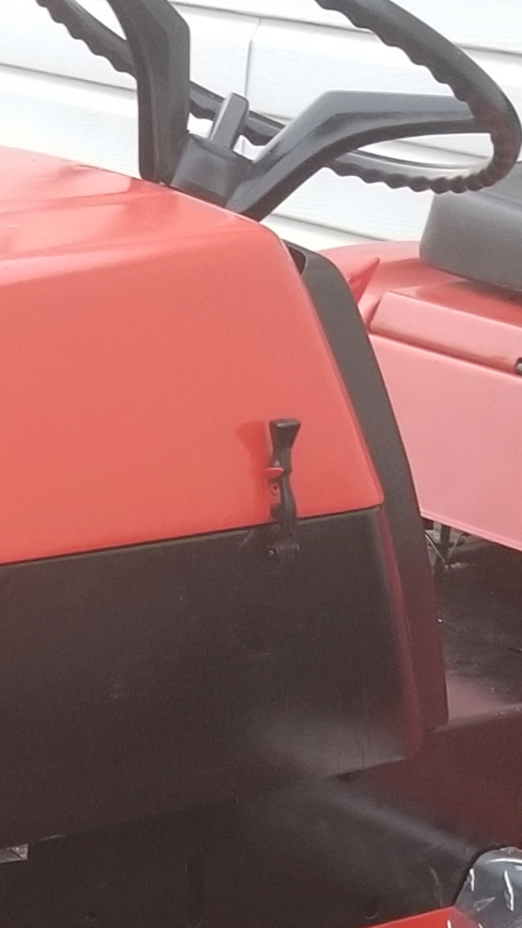

I've never really had a problem with my latch?. I did replace the rod because it was wore out. But then again I have a short frame so maybe the chassis doesnt flex as much?? But I also dont have the original mount for the hood because someone broke it so I made my own. I dont feel bad about modifying mine because it has the worst of the worst parts on it lol.

I like that under hood latch idea. That's a good way to hide a non-oem latch.
