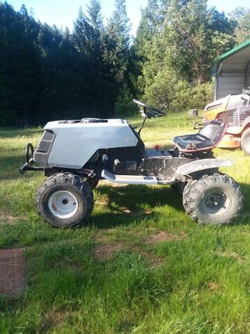

Today I swapped the front tires from the GT over on the the rally mower. I just put a pair of turfs on the front of the GT for now. The fronts are 18×7-8s which happened to be the fronts the pair with my rears which are 18×9.5-8s. They are both SunFs of the exact same tread pattern. To be honest I have been planning this for awhile now.
Craftsman 18hp Rally Mower - Page 7 20190419
Craftsman 18hp Rally Mower - Page 7 20190420
Craftsman 18hp Rally Mower - Page 7 20190421
I think it looks great! Aside from the fact that the front end is way to high. At least 3in higher then the rear. I intend on solving this problem by fabricating new spindles. Some Cub Cadets (including the 149) have spindles that are not J spindles but still use and axle with spindle tubes. People building GT pullers have also fabricated spindles like this to lower the front end on there tractor. If you don't know what Im talking about they look like this.
Craftsman 18hp Rally Mower - Page 7 20190422
Hopefully that should solve the issue. My exhaust may get in the way and have to be altered slightly. I am also still gonna look into the clutch in the next couple days.

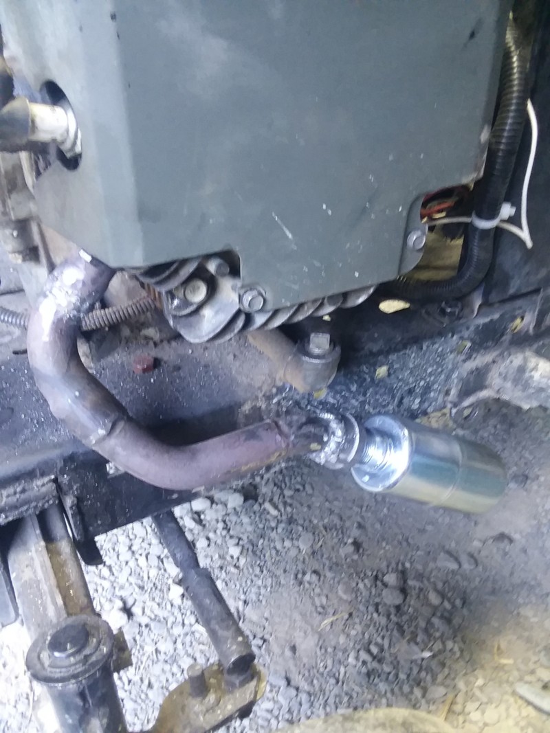

I added plumbing nipples to my headers so I can thread in these TSC mufflers when ever to quiet it down. My headers are alittle short so it back fires alot without them.
I am happy with all the mods and in the next couple months I will be dojnv a full teardown for paint! So expect some glammer shots!!

The frame had cracked right behind the front axle on both sides. I wasn't expecting this because I don't run big tires or do a ton of wheelies but I do jump it sometimes and because of the stiff front tires it impacts hard. As you can see in the second pic I just welded the cracks then plated them with a piece of angle.
