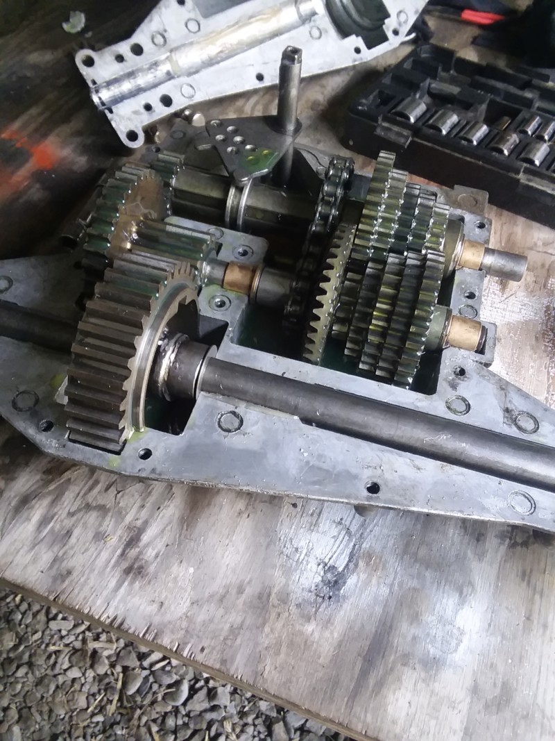

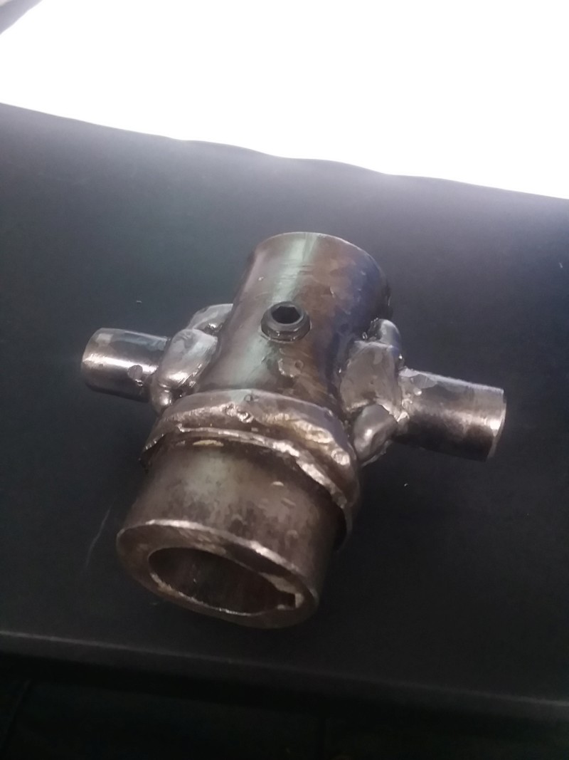

Since I have my trans taken apart I'll take this opportunity to show you how I did the center piece for my live axle swap.
Craftsman 18hp Rally Mower - Page 4 20190220
I took the center of an 8 in rim and cut it down to fit in the case. Then I cut the pin from the original diff and welded the ends of it on to the rim piece. I also drilled two 9/32 holes in it and tapped then to 5/16 for set screws.
Does anyone know what is the best weight oil to run in transaxles? I was going to get 85w-140 or 85w-90. What do you think is better?

85-90wt

Thanks! I have some 85w-90 laying around so I think I'll use that.

Huge day today I got alot done!
Craftsman 18hp Rally Mower - Page 4 20190221
Craftsman 18hp Rally Mower - Page 4 20190222
I cleaned the rest of the grease out of my trans and put in a brand new BMI KARTS 3/4×36 inch live axle. Ended up using 80w-90 lucas oil. And put it back in the tractor!
Craftsman 18hp Rally Mower - Page 4 20190223
Craftsman 18hp Rally Mower - Page 4 20190224
I used the 3/4 pillow blocks to build some axle supports. It seems like this should prevent it from bending easily and I can run the tires alittle wider. I also got my hubs on. I ran out of time but my tires are going on tomorrow!

nice ! i like the pillow blocks. Should add a lot of support and work well !

Thanks! Sincs I bent my last 3/4 live axle the hope is the pillow blocks will prevent that.

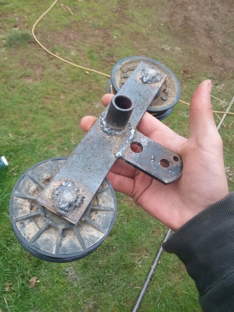

I'm loving the look of this thing. I could make it alot wider if I want but that would compromise some strength. It will look even better after I paint the fronts to match.
I have a 5in rear pulley and I got a 7in for the front but I didn't quite work out so I have a 6in on the front know. My stock clutch did not allow me to run anything larger then a 5 in the front and so I decided I needed a new clutch anyway.
Craftsman 18hp Rally Mower - Page 4 20190228
I put it behind the pedal so the linkage pushes instead of pulls but it seems like it will work fine.
