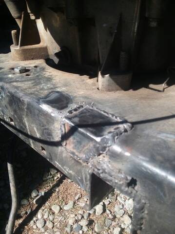

| Well I return again. I've been getting lazy with my updates so here comes another wave. I've been wanting to ride this thing so I just did a quick inspection before and found some carnage.   The frame had cracked right behind the front axle on both sides. I wasn't expecting this because I don't run big tires or do a ton of wheelies but I do jump it sometimes and because of the stiff front tires it impacts hard. As you can see in the second pic I just welded the cracks then plated them with a piece of angle. | |
