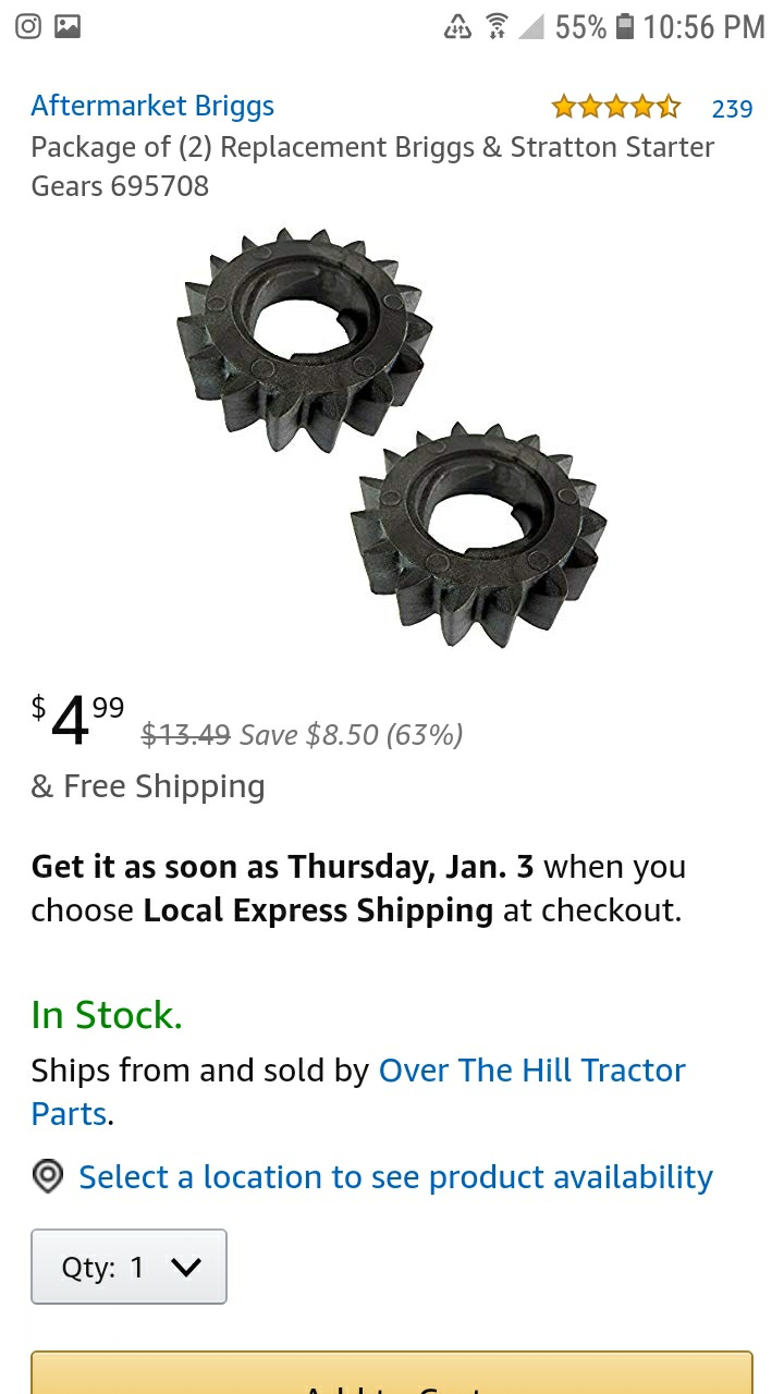

Well I bypassed the relays and buttoned up some other loose electrical. I charged the battery but when I went to start it it turned over a couple of times but then the starter started free spinning so I took off the engine shroud and found this! Time for a new starter gear I guess.

Ah, that sucks. I've had my Ford wreck three starter gears on me. Stripped the teeth off one, then the other two it actually split the gear right off. The nylon starter gears were really a horrible idea on Briggs' part, especially on the opposed twins.

Ya the metal fly wheel and the nylon gear is not a good combo.

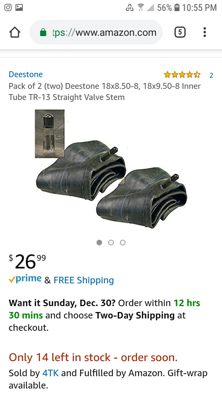

Just ordered some stuff on Amazon for this project!
Craftsman 18hp Rally Mower 20181229
New tires!
Craftsman 18hp Rally Mower 20181230
Decided to run tubes. I do all my own tires and some times getting the beads to take is a pain. Tubes are just easier.

New starter gears. 2 for $5 nat a bad price.
