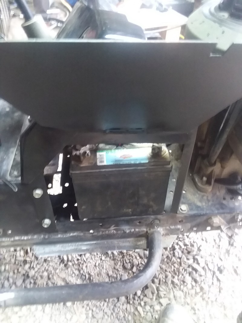

| I made an access panel to get to the battery    I just used an old hinge I had lying around and the peice of sheet metal is off of a Kemp wood chipper.  Gas tank is in I just need to go hook up the line and filter. Does anyone know if my shut off shoud go before or after my filter or does it not matter. | |

| Very nice job with the battery re-location! I like it a lot!
Also, I like to put the shut-off between the fuel tank and filter, that way you can change filters without spilling all your fuel out. Also if you need to remove the tank for any reason you can unhook the line right after the shut-off and remove it with the tank. _______________________________________________ "This'll either wake you up or put you to sleep forever!"- Red Green "Whatever you do you should do right, even if it's something wrong." - Hank Hill - MTD Off-Road Build - Ford LT 110 Off-Road Build - Craftsman GT 6000 Off-Road Build - Sears LT11 Rat Rod Build *2019 Build-Off Winner!* - Allis B-110 x2, 710 & 716 - Wheel Horse 655, 953 & 500 Special - Case 444 - Bolens Versamatic & 1668 - Cub 106 & 124 - Ford LGT 125 & 145 - White 1650 Yard Boss | |

| I like that side access to the battery! | |
