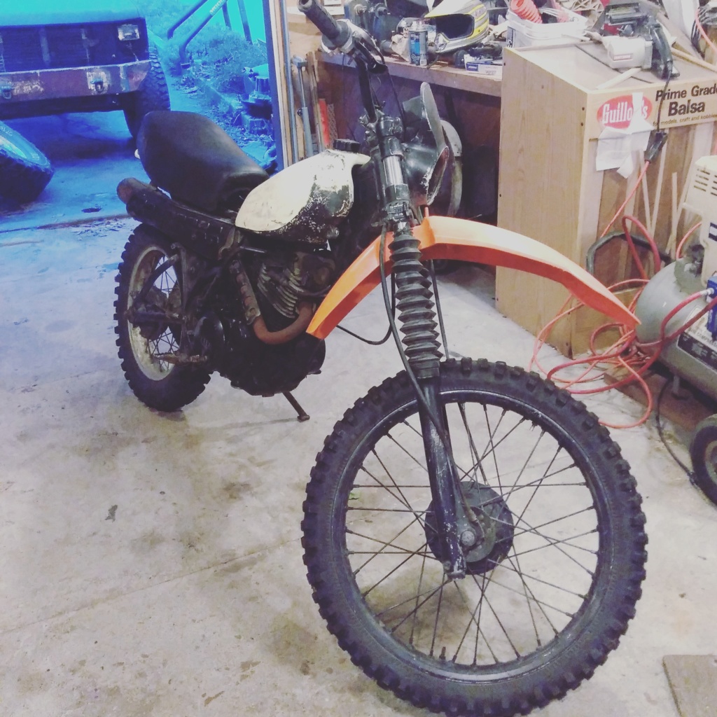

Ok to start this off, these are two bike I just traded my chinese 150 Pit bike and my pressure washer yammy for. One is a 83?? Yamaha XT250. It was running when I bought it but it had a terrible tick so i'm taking at all apart. The other bike is a later 80's Husky bike. For now im just going to neglect it because i'm starting off with the XT and this one is missing a few parts.
Muck's ol' bike collection. Img_2045
Muck's ol' bike collection. Img_2044
I'll post more updates and show my other bike later.
I'm busy with the troubles that the XT is giving me now Mad

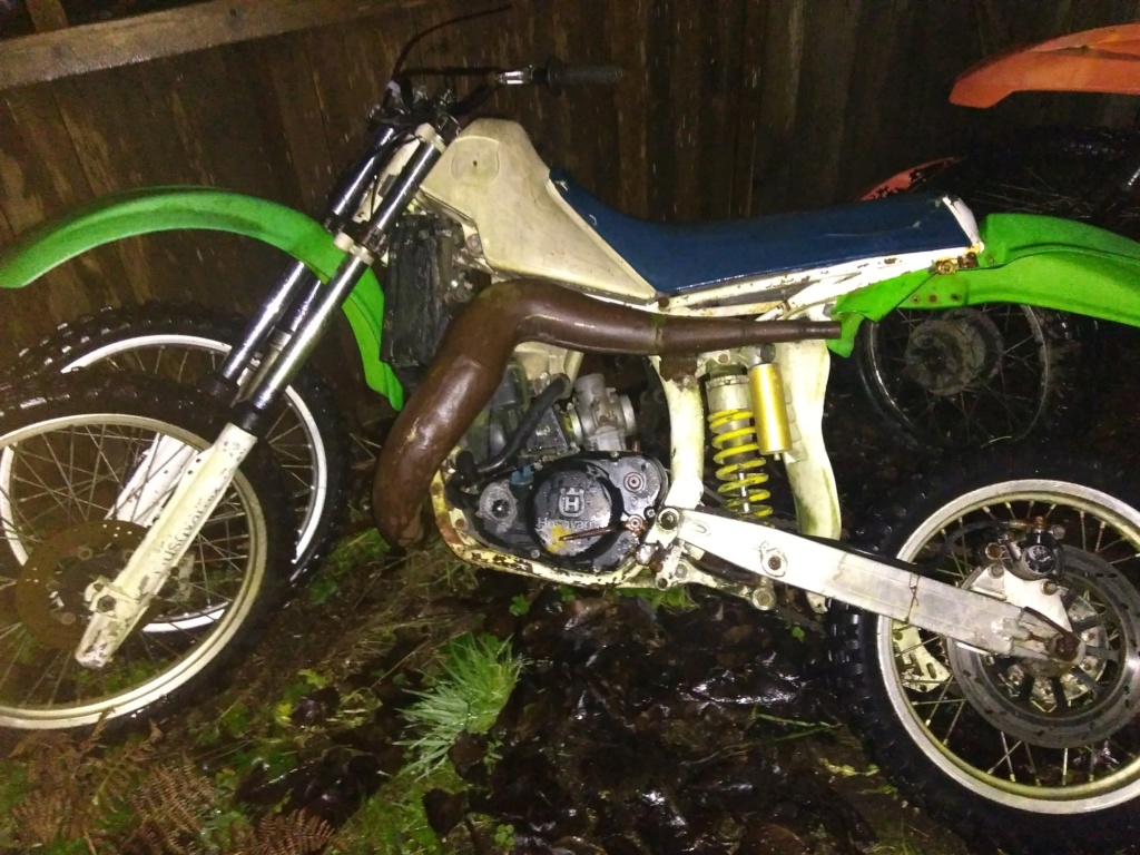

Today I got tired of working on the XT, it has me defeated currently. I decided to roll the Husky into the shop and tear it down. It cama apart easilly in just over an hour. The paint is very rough, so I think i`m just going to sand it down and put a coat of white paint over it to make it look good and increase the value if it does work.Muck's ol' bike collection. Img_2047
I then started to tear into the engine because it felt seized. It truns out it wasnt seized, but instead there was just a little peice of sand between the clutch and the crank gears preventing it from turning. Still to my pleasent surprise however, It looked like this.

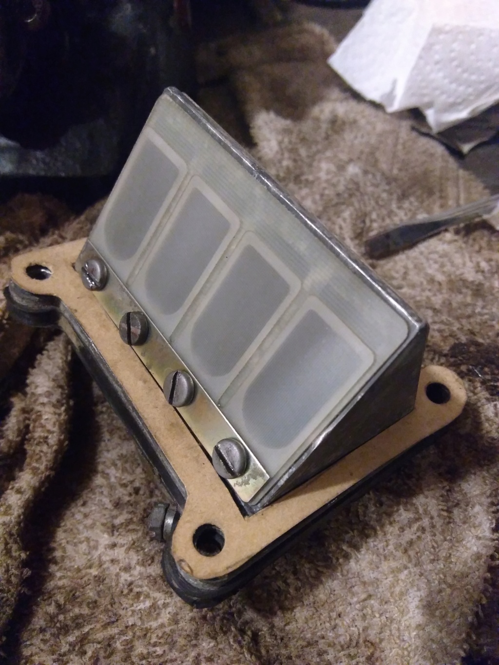

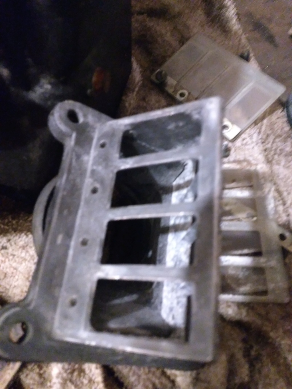

I removed the reed cage too so that cleaning was easier. It turns out the aluminium was all corroded and gross so I brushed and sanded what I could off with some small wire wheels. I cleaned the petals and stops and made a new gasket because the old one was soggy and broken.
Muck's ol' bike collection. Img_2050
Muck's ol' bike collection. Img_2049
