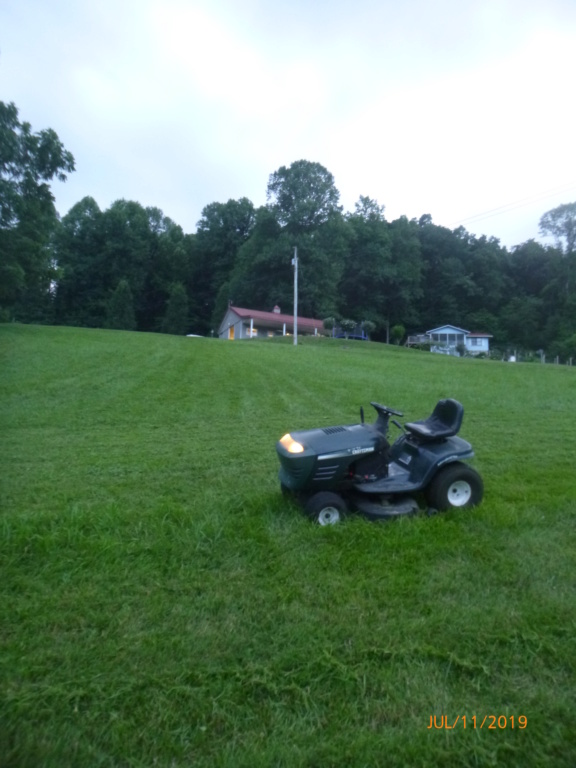

Alright boys, so the Craps-man is in the best condition it's ever been since I've owned it, all it needs now is a transmission pressure release rod, and a new motor. The headlights work, the clutch is working correctly, the back of the seat and a portion of the dash has been repainted, and the tires hold air ($30 for that). Anyway, with the horrifying knock, it mowed about 3.5 acres of fairly thick grass and it did the job nicely. Of course it had its complaints, and it took all day (Which normally takes about 5 hours with the JD) but it still did it.
This hill was a beast, matter of fact it's the one that showed me the real gremlins of the Craftsman, but the Craps-man did it.
Murraymountain's Lawn Tractor Repairs - Page 4 P1110423
The Craps-man mowed everything in this one and the pic above and then some.

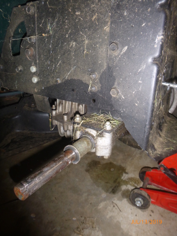

AAAAAAAAAAAANNNNNND.... HYDRO TEARDOWN!!! No springs and other crap flew out! BUT, I found several red flags. As soon as I removed the first wheel, the axle literally fell apart. A big chunk fell out first, and then I noticed the crack (white circle)...
Murraymountain's Lawn Tractor Repairs - Page 4 P1110426
Here's some oil that leaked out of the tranny, not sure how it got there...
Murraymountain's Lawn Tractor Repairs - Page 4 P1110427
Tranny apart...
Murraymountain's Lawn Tractor Repairs - Page 4 P1110428
Then I realized just how bad it is... Everything in blue is a crack...
Murraymountain's Lawn Tractor Repairs - Page 4 P1110429

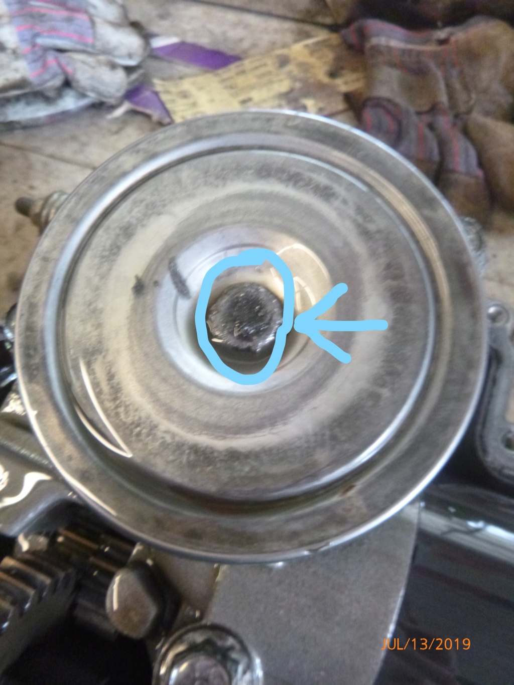

Another alarming thing... In the blue is shredded metal stuck to whatever that thing is, as if there's a magnet underneath it... That's not supposed to be there is it?
Murraymountain's Lawn Tractor Repairs - Page 4 P1110430
Here's the piece that chipped off...

So, I watched a video on YT of a guy rebuilding his MTD hydro (had all the symptoms mine had), and it turned out to be the hydrostatic motor. I haven't done much research, but at the moment, I can't find a new hydro motor, I can't find an axle half (only the entire diff, and that's $662), a brass bearing is $20 (not too bad), and a filter is $50 I think. So, I'll be doing some serious research.
When I asked the price of that parts mower at the junkyard, the second he opened his mouth my jaw hit the ground, So that's out (and I needed that thing).
So I now have $200 (bought a new deck belt) in the Craps-man, and it's gonna need a connecting rod, probably a carb, and another 15 man hours. This machine doesn't stop.
I have $7.50 in the Craftsman, so I have a lot of room to play with this one.
I'm also going to fully disassemble the hydro, does anyone know if I'll need a special tool to get the pump back in like RedneckComputerGeek said, or am I just gonna see what happens? lol.

JEEZ that is pretty bad that the axle crumbled around the key, pretty weak.

Most certainly was, I was shocked to find it like that. It's cracked, sheared, swelled, and warped, so I'm definitely not using that again.
Well, I took the pump and motor out, and all the pistons seem to have pretty much no play in the bore, so I guess those ain't the problem. The 3 bolts that hold the pump on were so tight, I had to wedge the case in between the barn doors and hold them shut while someone else used a breaker bar to get the bolts out.
So, the issues so far are: oil leak, bad filter, busted axle half, broken brass bearing, and metal shavings all throughout the case, fitler, and input shaft. Could any of that cause jerking and not wanting to go uphill?

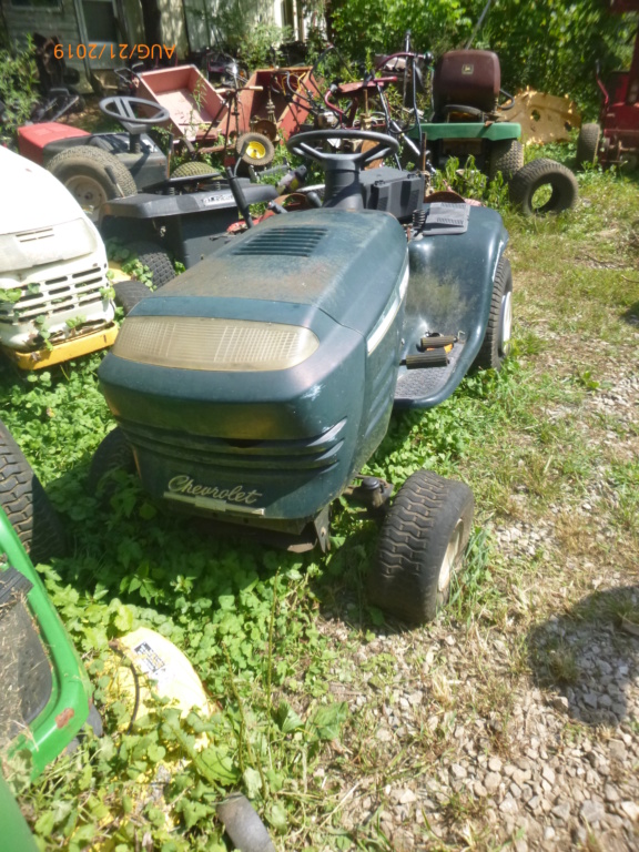

Anyway, when I went to the junkyard, I knew I had to eliminate the Craps-man, so after looking around, I bought this for $100:
Murraymountain's Lawn Tractor Repairs - Page 4 P1110639
Murraymountain's Lawn Tractor Repairs - Page 4 P1110640
Murraymountain's Lawn Tractor Repairs - Page 4 P1110641
Another, "Chevrolet", LT1000. 16.5 Horse Kohler Command with the hydraulic valve lifters, full pressure lubed, fuel pump and all the good stuff, a hydro that seriously needs some penetrating oil, and no deck. I heard this motor run a little over a year ago, so I know it'll run, but the wheels are SERIOUSLY rusted on the axles. So I'll be breaking out the sawzall and the grinder when I pick it up. The Craps-man is donating its good parts to this one (deck, clutch spring, seat, etc.). The Craps-man's body will be cut up and used as rear fenders for the gray Murray, and the frame will go to the Scat Rat. So all that will be left is the hood, steering, deck engagement and lift assembly, and a trash engine. Anyway, this'll most likely be an, "over the winter" project because of how much it needs. I'm not sure I'll make any money, but it'll make some room!

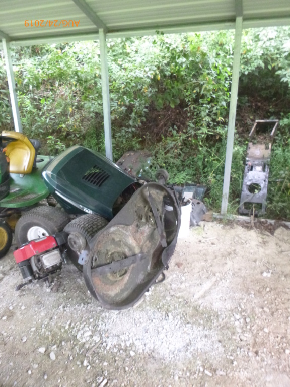

She gone:
Murraymountain's Lawn Tractor Repairs - Page 4 P1110642
Yes sir, the Craps-man has met it's fate.
All loaded up and ready for the parts pile...
Murraymountain's Lawn Tractor Repairs - Page 4 P1110644
Murraymountain's Lawn Tractor Repairs - Page 4 P1110645
I believe this is getting cut up and will become rear fenders for the gray murray...
Murraymountain's Lawn Tractor Repairs - Page 4 P1110643
Trash motor that will probably be parted out, but I may throw it on the MM or the beater when one of them do a connecting rod delete:
Murraymountain's Lawn Tractor Repairs - Page 4 P1110646
I really need a storage shed:
