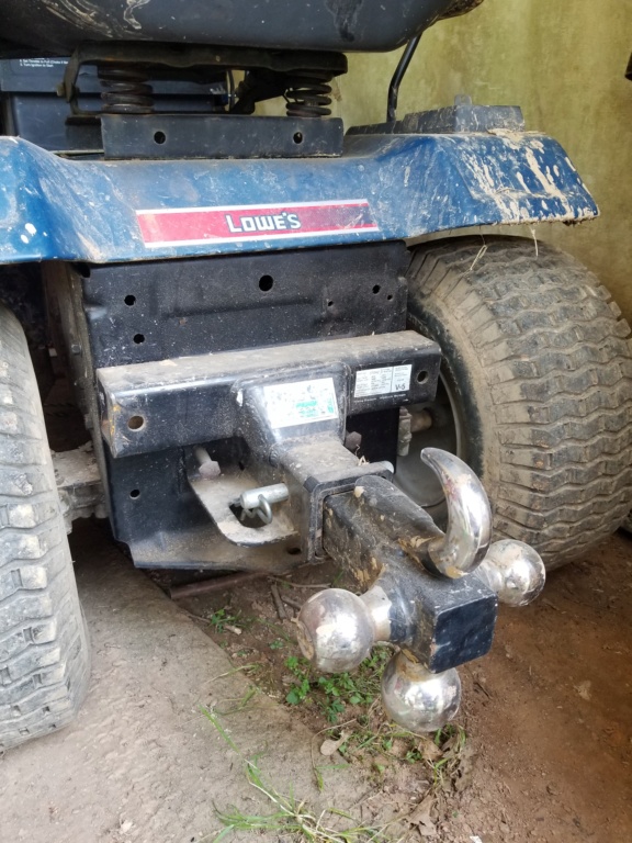

I decided I needed a stronger hitch than the factory mower hitch.
I had this reese universal hitch off of an old van. I cut it down to the same width as the rear plate of the mower frame. There are 2 1/2 inch grade 8 bolts holding the main frame of the hitch to the plate and 2 more behind the chain hooks.
Free Lowes Mower  20190510
