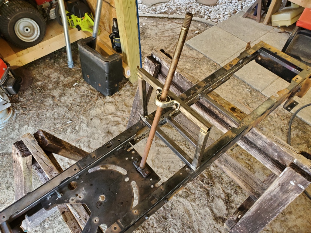

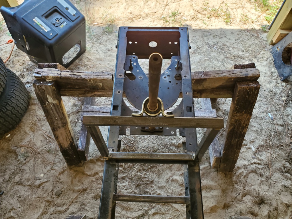

I will keep all the steering and linkages stock for now, seem to be more rugged than other models I've seen. The mower will probably never see mud as there it none around...just sand and clay in my area so undecided on tires right now. I was considering using some golf cart rims and some hubs for bearings staying with 8". Being hard sand where I plan to ride I don't need to go aggressive with tires.
   I have most of the frame supported now but still need to weld in the engine plate and trim the steering plate for pulley clearance.
Murray Widebody Build "Ol' Yeller" 20190911
Murray Widebody Build "Ol' Yeller" 20190912
I made a steering shaft support out of 3/4" stock and a 5/8 bearing and carrier. This will be bolted down through tower, floor pan and to a 1/8" flat steel piece welded to the frame. Getting the angle right was a PITA but turned out to fit nice and tight in the tower. I needed to make this removable for future servicing. Hoping this will firm everything up.

Clean steering job!
