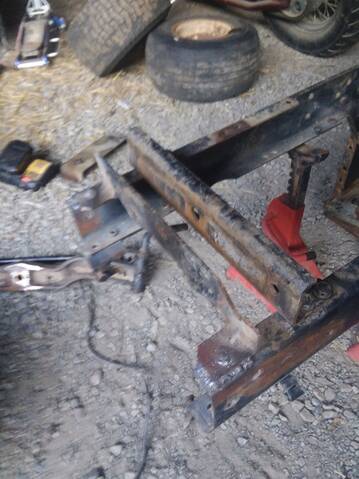

This was the state of the tractor about a week ago when I started this.
I got the axle carrier moved forward again but this time I welded the front part of it in and improved the pivot point.. maybe.

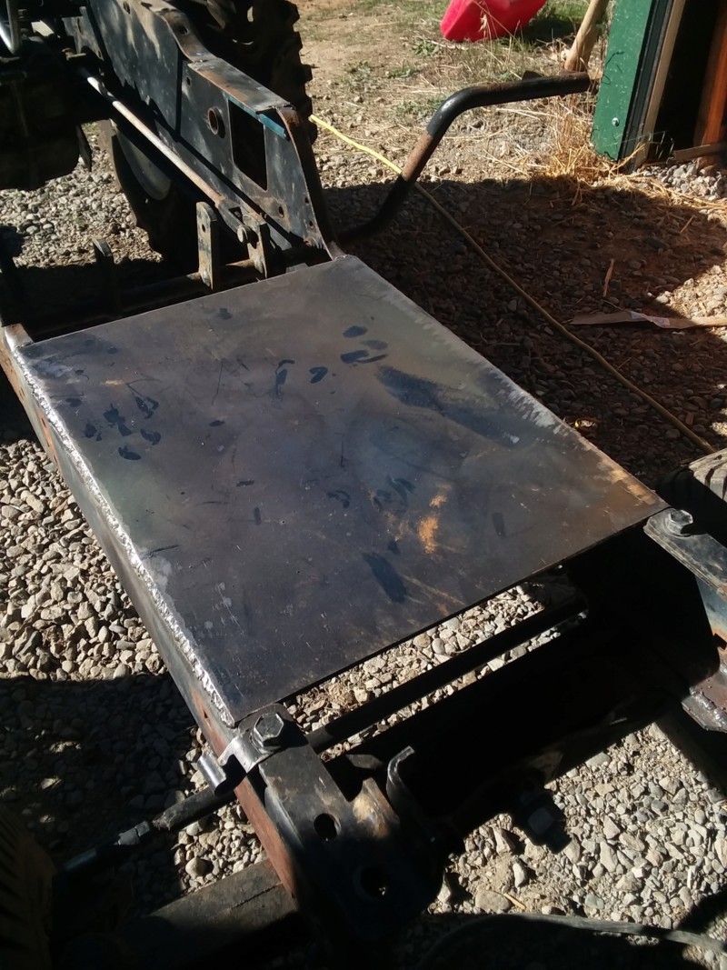

The trans is in and locked.(moose knuckle technique)
Craftsman GT Revive! 20191115
The egine plate is welded on and should work perfectly. It's 12 gauge I think. I started work on the jackshaft mounts I should have pics of that this evening.
