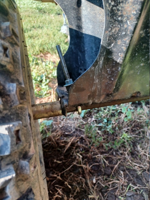

So I have been needing to rebuild Putt Putt's firewood trailer for some time now as the whole axle mount broke off, so I rolled it into the shop.
1969 Sears Suburban 12 "Putt Putt' - Page 2 20230830
1969 Sears Suburban 12 "Putt Putt' - Page 2 20230831
It a Agri-Fab ATV trailer with a 1 inch axle and a pretty robust tongue and balloon tires which are great for the snow!
The problem all began when my wheel bearings locked up and broke my mounts as it must have happened when I was driving. There are pretty bent up and one is cracked. Because of this the back of the bed is not secured to anything so that needs to be fixed as well. So I took the bed off and marked the center of the axle.
1969 Sears Suburban 12 "Putt Putt' - Page 2 20230832
After thinking about it for a while and looking for a solution I found some U-bolts and bent them to be tighter round the axle and drilled holes in my tongue where the OG mount was to mount the axle that way.
1969 Sears Suburban 12 "Putt Putt' - Page 2 20230833
1969 Sears Suburban 12 "Putt Putt' - Page 2 20230837
This actually worked great! It held the axle very tight and sturdy. I also used some ThreadLocker so it dont come loose.

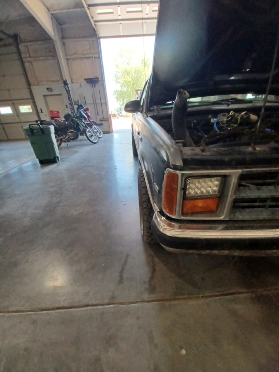

Haven't worked on this trailer yet I had to work on my 1987 Dodge Dakota.
1969 Sears Suburban 12 "Putt Putt' - Page 2 20230841
1969 Sears Suburban 12 "Putt Putt' - Page 2 20230842
Sorry for the absolute photo dump and random truck pics.
