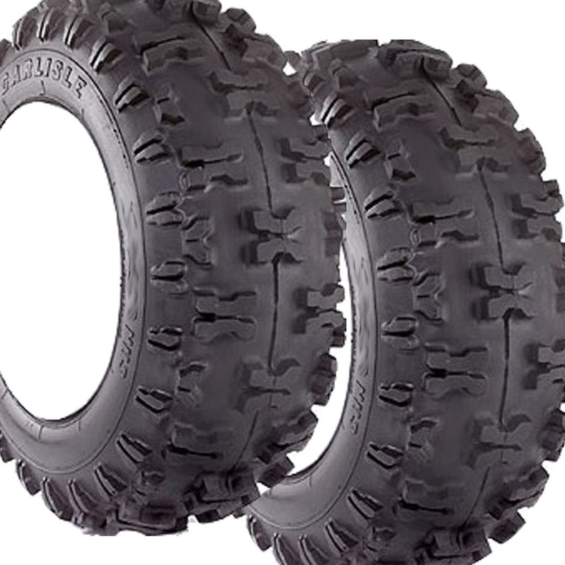

Looks good! I think a set of 18x6.50-8 Carlisle Snow hogs would look good on the front, and from what I've heard they perform really well

Thanks for the compliments guys yes that is a lawn roller the plan was that it would act as a roller as on some jeep front bumpers but it didn't reall do anything. And yes I've looked into new front tires I upgraded to a set of 18 inch tires off of a stx38 that my friend built but another friend just put a set of 19s on the front of his I'll find a pic of them that I tried on the Sears it's just that I had the 18s and they made the Sears look level so I was happy.
