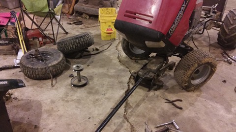

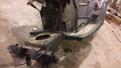

| So this things kinda blown apart right now...  Beefier Murray GT steering gear? I think yes.  Beefier Murray GT spindles, wheels, and bushings? Also yes.  So that's the entire Murray GT steering setup in the LT. Cool, lol  Also you can tap the hole in the end of these steering shafts to 1/4-20 so you don't have to use the stupid clips. I'm also using the Murray GT steering wheel.  Rip Murray GT  So all I've really gotta do now is get down to TSC and get a belt, and work out some belt keepers. Hopefully. | |

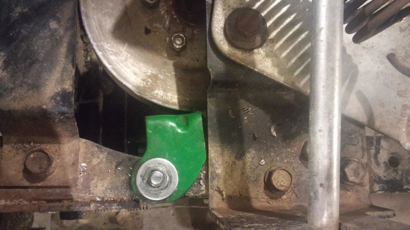

| I'm sure I have everything to make one for Orion. Just gotta put the thought into it. I already have an idler there to keep the belt off the shifter lol. | |

| Well fellas, I believe I have the belt issues worked out on this sucker. Got an inch bigger belt from napa. Was worried for a second it was too small, barely slipped over the back pulley. Luckily it's a deep well pulley and this belt should work. Added an adjustable belt tensioner/idler to keep the belt off the shifter like Mighty has there, and put on a bunch of belt keepers. One for rear pulley(actually half of mutt's old seat mount that my 155lb fat arse broke in half lol idek), one for the engine pulley, one for the clutch idler(replaced with a smaller idler, didnt have any the right size so it needed something different), one for the adjustable idler, and one under the left side of the belt so it doesn't droop so much. Both of the belt keepers for the idlers were pieces cut from Mutt's old green fender, was scrap anyways and the thickness I wanted. Seeing the old ATLTF.COM MUTT lettering makes me wanna do something similar to her new fender.... AAAAaaaannnyways, if all goes well and i get up before like 3pm, I may have this pos driving tomorrow!!! Pic of belt when I first got it in. Mutts seat mount in original orientation on this machine as a idler bracket lmao  John Deere green Mutt's seat mount turned idler bracket turned belt keeper lol.  I can confirm that it is 100% easier to buy the damn $16 belt than to fug around with idlers and stuff all day. This is the second time I've learned this lmao. Sorry for the lack of pics folks, blah blah blah excuses was on phone with gf dammit I'll snap a few tomorrow i just wanna go to bed its fugin almost 6am | |
