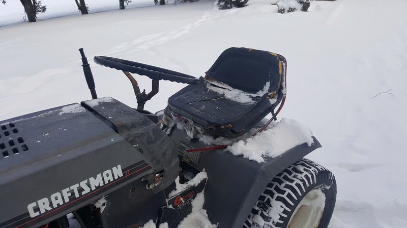

| So I did some work on the ol' GT 6000 today.  My throttle and choke cables both froze up, so I just have the choke disconnected until I make it to Canadian Tire to pick up a different one. But as for the throttle, I figured this was a good time to make a foot throttle. So I did!   Works great! So much nicer to drive now. And I finally got rid of that hilariously destroyed steering wheel.   A steering wheel I took out of a '79 F100, I think it looks nice and it's quite durable. Hell anything's better than that other steering wheel hahaha. Let me know what ya think! _______________________________________________ "This'll either wake you up or put you to sleep forever!"- Red Green "Whatever you do you should do right, even if it's something wrong." - Hank Hill - MTD Off-Road Build - Ford LT 110 Off-Road Build - Craftsman GT 6000 Off-Road Build - Sears LT11 Rat Rod Build *2019 Build-Off Winner!* - Allis B-110 x2, 710 & 716 - Wheel Horse 655, 953 & 500 Special - Case 444 - Bolens Versamatic & 1668 - Cub 106 & 124 - Ford LGT 125 & 145 - White 1650 Yard Boss | |

| I like how you're using parts you have on hand for this build, like the steering wheel and re purposing the factory hand throttle into a foot throttle. How's the return action on the foot throttle with the solid type of cable. | |

- I like how you're using parts you have on hand for this build, like the steering wheel and re purposing the factory hand throttle into a foot throttle. How's the return action on the foot throttle with the solid type of cable.
Thanks Carl! Belive it or not the return spring pops it back to idle every time. I was surprised knowing how stiff these mechanisms and cables are. - RichieRichOverdrive wrote:
