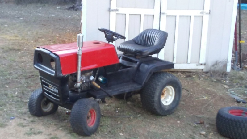

| Wow they look great on that body style ! wish i would have done that on my craftsman lt1000 when i had it . What does it lack to test drive ? wiring is optional after all | |
 | Subject: Re: Craftsman LT1000 "NellyBelle" December 30th 2017, 9:22 am | |
| Belt is finicky, whenever I shift, even without using the clutch, the belt comes off. I think I know what it is, though, I'll try to work on it later, I need it on Monday. | |
 | Subject: Re: Craftsman LT1000 "NellyBelle" December 30th 2017, 9:29 am | |
| Might need some belt keepers and your pulleys could be out of alignment .
Age : 47 Join date : 2016-09-06 Posts : 8498 Location : Oklahoma
 | Subject: Re: Craftsman LT1000 "NellyBelle" December 30th 2017, 10:08 am | |
| Looking back at your pictures, looks like your belt is twisting for some reason?  I don't see why it would.  Look at your pictures from earlier on the non-clutch side.   Maybe it is just an optical illusion.  Also, maybe an illusion, is your transaxle pulley parallel to the belt?  Looks to be tilted down? I see front bracing on that, so probably an illusion.  10lb weighs inside your rims?   ...but definately a couple more belt guilds. Maybe one here?  Then maybe a couple here?  If like drawn, that would be a stretch, and would need to be strong or some kind of bracing in there. If that still does not work, maybe another J guild to hold a clutched belt from sagging too much?  The clutch is pretty close to the engine allowing for a lot of unsupported space. If that all still does not work, maybe look at that engine pulley?  Looks like you have a 5/8 belt and that pulley looks like a 1/2 groove?  The belt seems to stick out of the V a bit. Only other thing throwing me in your pictures, in one the belt is frame side of the clutch pulley, in the next it is center of the frame side of the clutch pulley?  First 2 pics of yours that I reposted.  You have a double pulley?  If so that is good. Sorry, that was a awful lot of info I feel.  Just want you to be able to get your rig out and have some FUN! _______________________________________________ Tractors: Li'l Red - 89 Murray Widebody TheGreenMachine - 89 Craftsman GT18 Bowser - 01 Murray Widebody LT Phoenix - 75 Sears ST/16 Dirty Rat - 77 Sears Suburban Kal-El - 82 Murray GT Have a question? Ask me! Type in "@MightyRaze" in your post! | |
 | Subject: Re: Craftsman LT1000 "NellyBelle" December 30th 2017, 10:19 am | |
| pretty sure Its a 1/2" belt , but the pulley in front is cast aluminum and not designed for clutching aplications with more that 1 or 2 hp . the clutch is most likely the issue if its not the drive pulleys because of how junky those style are and have one pivot point with very thin steel so it does flex under tension . but the front pulley looks pretty low on the shaft so that could be the issue . | |
 | Subject: Re: Craftsman LT1000 "NellyBelle" December 30th 2017, 10:34 am | |
| The tranny is loose, and it rocks when you shift. The belt stays on when the bolts are there, and you can fully operate the clutch. I do need belt retainers, but the main issue is trying to keep the horizontal bolts in the tranny. I was told by the manufacturer that the pulley was cast iron. Don't know if it is true, its not very heavy. I'm sure the front pulley is in alignment, idk about the rear. I'll look at everything later. Thanks for all the help!!! | |

| Or...I have a Peerless 5 speed. It came out of a 77' Rally Roper, and as far as I know, it is the original tranny, so it's 40 years old.... I don't really want to because I always hoped to get the Roper running again. I painted it and cleaned it up and it looked really good! Before:  After:  It has a really cool looking body, and it is very unique! There are very few out there. The engine is now the engine this build, cause I wanted a v-twin in the Roper. The tranny is slightly damaged. The input pulley is hard to turn, but it didn't do that until I opened it, so I must have messed it up....  Here's the damage, looks like someone high-centered it on a rock, and then tried to rock it back and forth.  It's more noticeable on the inside. Tips on the input pulley issue??? | |

| Got the wiring almost done, need to do the headlights and finish drilling the ground wire. I'm gonna put belt keepers on, then glue the bolts into the tranny, then I should be ready to drive!!! | |

Got the tranny bolted in place, now I need to put the seat on, gonna take it up the road to a friends house in the next few days. Will get a speed reading then. Didn't get too much work done, it was 14 degrees outside with wind and mist. Didn't stay too long! | |
