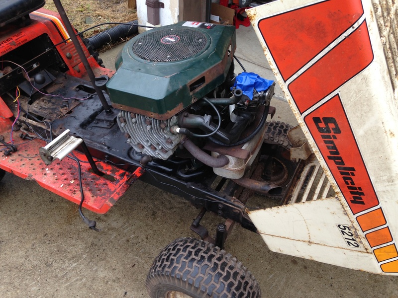

Finally the opposed runs, carb is rebuilt and turned out the fuel pump line was clogged, replaced and its all good.....
Simplicity Mouse - Page 3 Img_7110
Motor  is coming out & going into my wheel horse.

at first I thought the motor was floating in that picture! Isn't the wheel horse a horizontal shaft?
Points : 4877
Posts : 2639
Simplicity Mouse - Page 3 Empty
PostSubject: Re: Simplicity Mouse   Simplicity Mouse - Page 3 Icon_minitimeFebruary 18th 2018, 8:23 pm
Well, you can convert them easily.
AH! GHOST ENGINE!! I thought the same thing. LOL.
Most are but not mine...vertical motors....

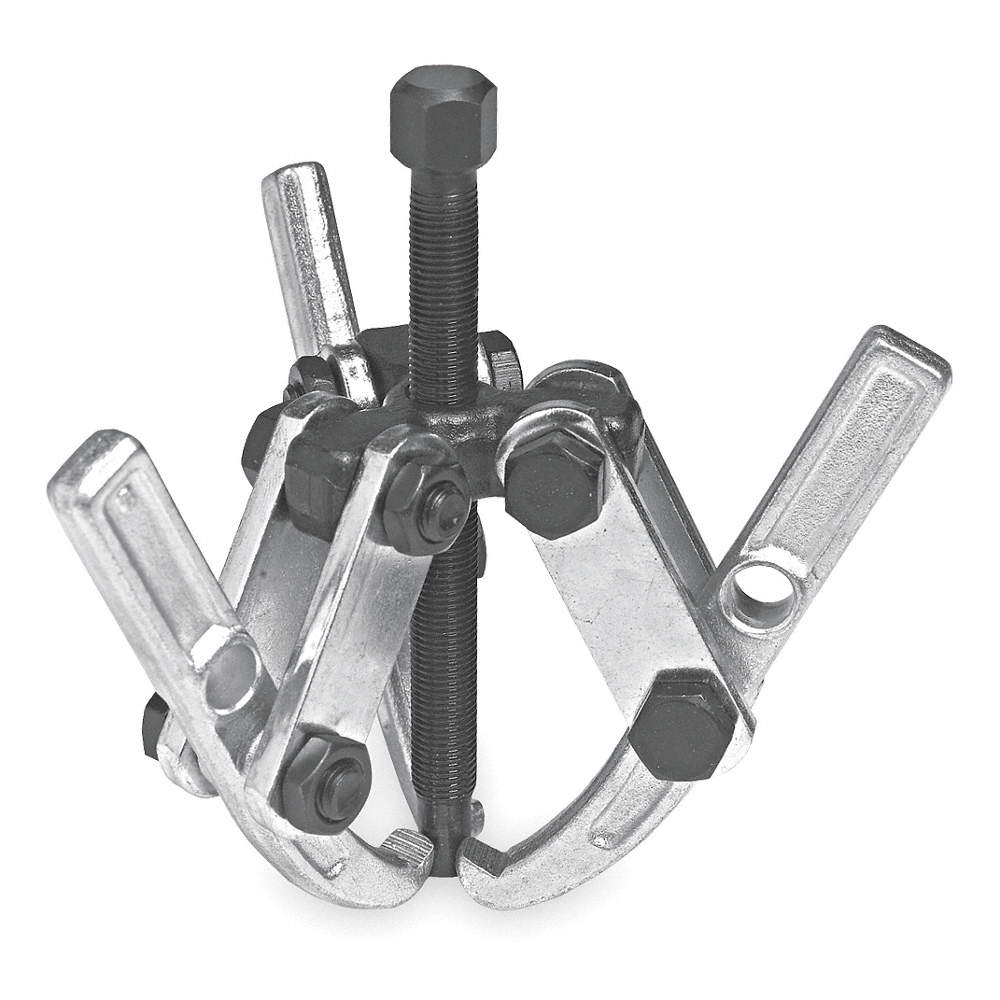

what is the best way to remove that engine pulley? I think it has a bolt in the middle? Then puller?

I usually have to use an air impact hammer. The bottom pulley is always trashed when I do though, but it comes off

A good puller.
If you want to save the pulley, you will need to be more patient. If it doesnt slide off, or if you see it start to mangle the pulley back it off. If you have one of those small handheld propane torches that will work. Put the fire to it for about a minute or so. Spray some liquid wrench on it, not all over the thing, just where its needed. In the keyway and around the seams. Let it soak in for a while. Come back a bit later and put the fire to it again, then liquid wrench, then, go watch some Red Green on youtube.  Simplicity Mouse - Page 3 2664539216  When thats over, do the process all over again. After 3 or 4 times try the puller again.
Now, when you got to put any pulley back on any shaft, or hubs or whatever... put some anti-seize on the shaft!
Makes it loads easier when you, or the next guy has to take it off. Simplicity Mouse - Page 3 2731072446

My procedure is as follows
Remove bolt
Find a spot on the lower pulley I can get at the right angle
Pull the trigger and hammer away.
This will destroy the pulley stack, but since I never use them I don’t care. You might though. If you’re more patient and want to keep the stack, do what Beal said

I usually use an impact gun to remove the bolt because then I don’t have to worry about keeping the crankshaft from spinning. I agree with these guys if you don’t want to save the pulley you can remove it in minutes or you can take your time and let is soak in penetrating oil and try to save it. I use the two or three jaw pullers too.

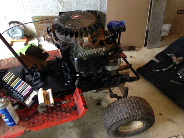

swap is starting.... first two issues are the exhaust needs a notch in the front frame... and the oil drain, needs to be reconfigured... hopefully i can use a pipe wrench to loosen it or something...
I got the side tins off ebay so i think ill be good with the cooling, just need a exhaust shroud...

PostSubject: Re: Simplicity Mouse   Simplicity Mouse - Page 3 Icon_minitimeFebruary 25th 2018, 9:04 pm
Dream big, custom exhaust! It doesn't have to be anything complicated, but I would do that before I cut a frame.
