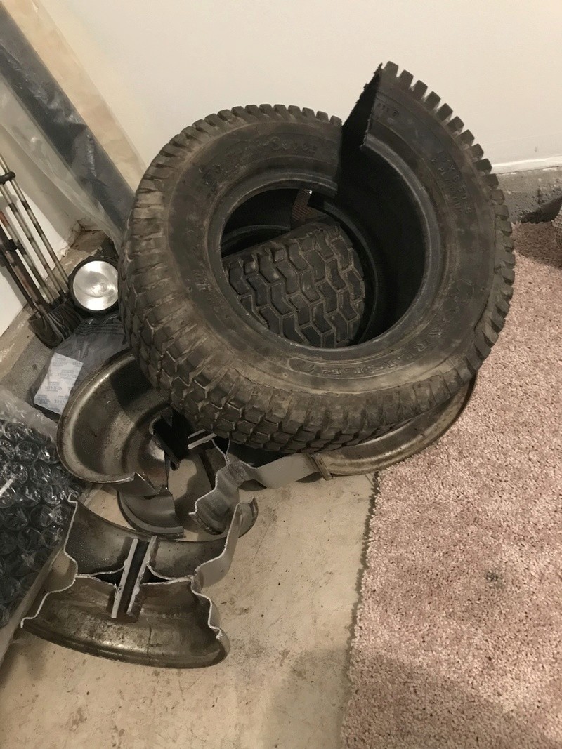

| Ok guys, big update. My valvestem-fix tire was flat when I came by today. Dunno if it leaked from the bead or the stem but it pumped right up and seems to be holding fine. Got the rear axle out and worked at those damn rear tires. No amount of heat or hammering would move em, so sawzaw to the rescue...   .....or not. These things would not give up. Got the grinder out and took a little more off and kept at it with the hammer. Finally let go. Here’s a pic of the carnage:  Also replaced the rear axle bearing while we had it apart. Ran to TSC and got a lower 3pt end. Cut the collar off of it and had the ball with the hole through it. Turns out I’m really good at eyeballing stuff because it was a direct replacement. Here she is on all fours:  Let me know whatcha guys think! | |

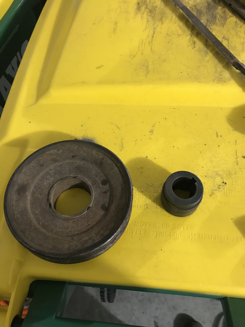

| Alrighty guys, successful pulley swap! Bought a hub from TSC, slid right into the old deck pulley, wouldn’t you know. I left my sawzaw at dads so was stuck with a hacksaw. Cut the stack apart and welded in the new hub (some of my better welds, I’m getting better). Used the belt that used to drive the deck as it was about an inch, maybe two longer in overall length. Took it for a drive and tops at a gps 10 mph, nearly doubling where it was before. Here are the pics:     Another thing I forgot to mention, I added sticky foam around the dash so it would stop all the rattling. Whole thing sounds so much better now!! | |
