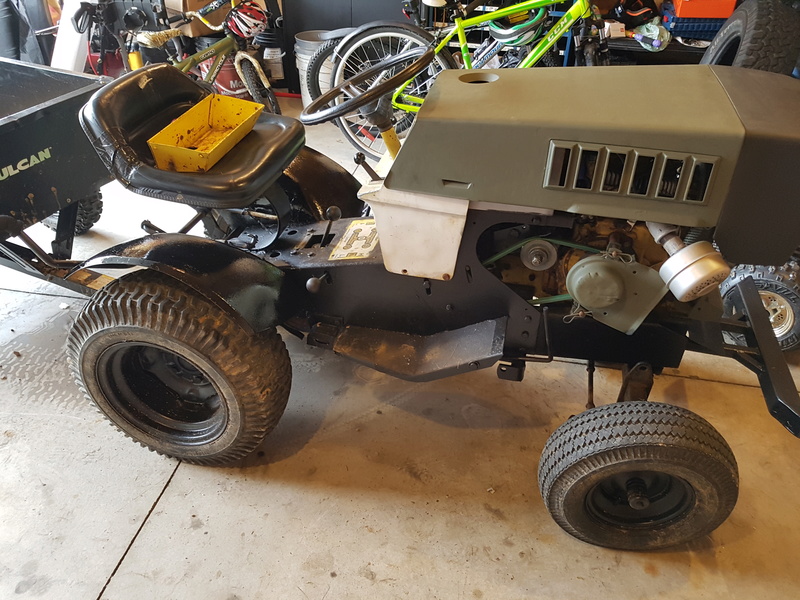

got it running kids wanted to go for a ride lol
started painting it( only temp) found some fenders, added the tool box and traded for some take off atv tires 673 sears workhorse/mudder  20170910
73 sears workhorse/mudder  20180315
73 sears workhorse/mudder  20170911
73 sears workhorse/mudder  20171012
with fender so much better

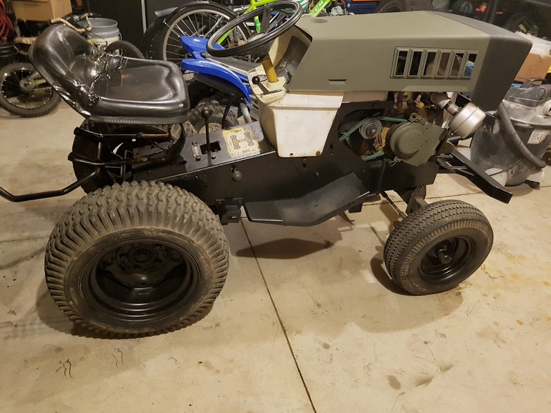

redid the wiring and wired in lights front and back
73 sears workhorse/mudder  20171215
73 sears workhorse/mudder  20171216
73 sears workhorse/mudder  20171015
New used meats man what a difference just need lock the rear sometime.
73 sears workhorse/mudder  20180316
73 sears workhorse/mudder  20171114
had to make a cup holder, and then broke the seat spring for the second time
