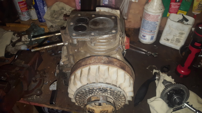

| Still tinkering away here, I got the piston and rod installed and the rod bearing bolts all torqued up:   Used the original rings because I'm just sorta building this for fun, I think they'll be fine though. Also got the points cover put back on and set the flywheel in place.  Gonna get it torqued up and then probably gonna have to get some gaskets for it so I continue keep re-assembling it.  "This'll either wake you up or put you to sleep forever!"- Red Green "Whatever you do you should do right, even if it's something wrong." - Hank Hill - MTD Off-Road Build - Ford LT 110 Off-Road Build - Craftsman GT 6000 Off-Road Build - Sears LT11 Rat Rod Build *2019 Build-Off Winner!* - Allis B-110 x2, 710 & 716 - Wheel Horse 655, 953 & 500 Special - Case 444 - Bolens Versamatic & 1668 - Cub 106 & 124 - Ford 120, LGT 125 & 145 - White 1650 Yard Boss *I have 21 tractors and over 40 chainsaws, I need help* | |

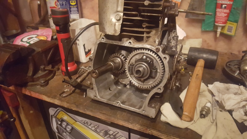

 | Subject: Re: Honda G200 Project Tue Oct 02, 2018 9:17 pm | |
| Little more progress on the little Honda last night. I had put the tappets and camshaft in place and set the timing a while ago:   But I finally got back to it last night and made up a crankcase cover gasket so I could get 'er sealed up. All assembled and torqued to the proper value:  Filled it with some 10w30 engine oil and waited for a bit to check for any leaks.  All good!! I let it sit over night and most of the day today and she's still dry, so it should be fine. I wanna maybe try and mess with the cylinder head a bit next, but we'll see what I end up doing, haha.  "This'll either wake you up or put you to sleep forever!"- Red Green "Whatever you do you should do right, even if it's something wrong." - Hank Hill - MTD Off-Road Build - Ford LT 110 Off-Road Build - Craftsman GT 6000 Off-Road Build - Sears LT11 Rat Rod Build *2019 Build-Off Winner!* - Allis B-110 x2, 710 & 716 - Wheel Horse 655, 953 & 500 Special - Case 444 - Bolens Versamatic & 1668 - Cub 106 & 124 - Ford 120, LGT 125 & 145 - White 1650 Yard Boss *I have 21 tractors and over 40 chainsaws, I need help* | |

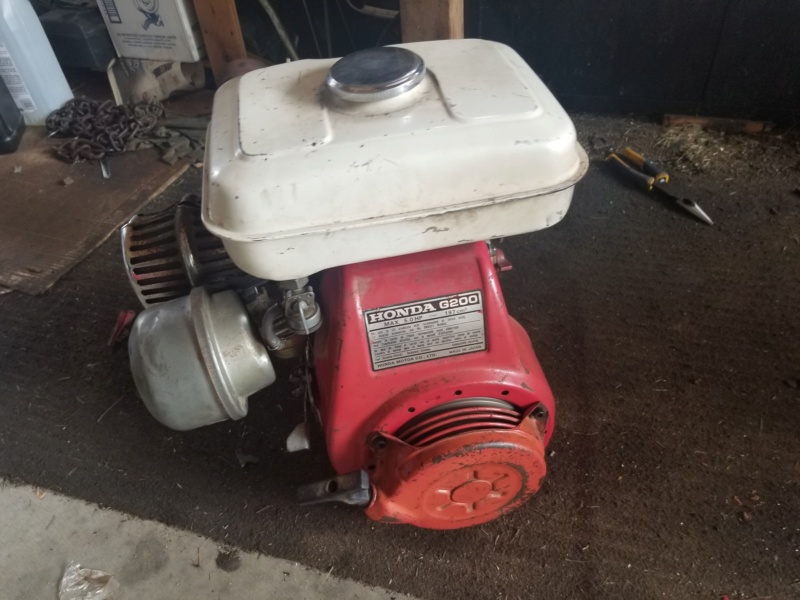

| Oh whoops, it would appear I've been neglecting to update the thread. My bad, haha Either way I got the little G200 fully assembled and running good some time ago. There are a couple videos of it running on my channel. I never had the recoil on it because the blower shroud was banged up a bit and that made the recoil sit off-center. Recently though I took the shroud off to straighten 'er out and got the recoil installed and working good! Had it running for a bit earlier today:   It's a good little runner! Usually starts real nice too.  Quite a neat little engine. Don't really have any plans for it I guess, but it sure is fun to have around, haha.  "This'll either wake you up or put you to sleep forever!"- Red Green "Whatever you do you should do right, even if it's something wrong." - Hank Hill - MTD Off-Road Build - Ford LT 110 Off-Road Build - Craftsman GT 6000 Off-Road Build - Sears LT11 Rat Rod Build *2019 Build-Off Winner!* - Allis B-110 x2, 710 & 716 - Wheel Horse 655, 953 & 500 Special - Case 444 - Bolens Versamatic & 1668 - Cub 106 & 124 - Ford 120, LGT 125 & 145 - White 1650 Yard Boss *I have 21 tractors and over 40 chainsaws, I need help* | |
