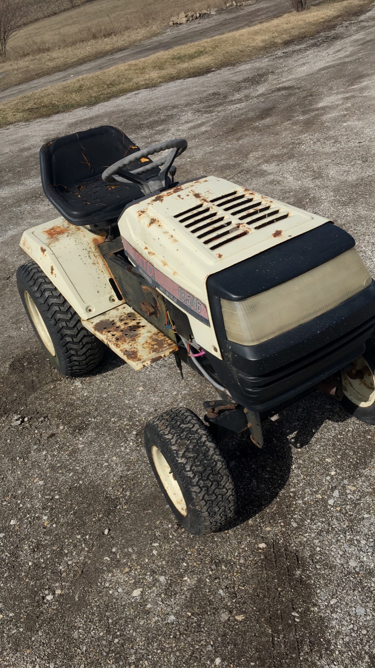

 | Subject: Re: Mtd gt “tetanus” March 18th 2020, 8:26 pm | |
|  So I finally got this thing to run and drive! I cleaned the magnets on the flywheel, cleaned the carb, and rebuilt the fuel pump now it runs beautifully and starts right up. I managed to get some full tins off another engine for free when I bought my toro so that problems out of the way. This is gonna be a budget build that I won’t be using or working on much but right now I’m gonna put some 20x10x8 tires on the front to give it better float and also I plan on deleting the varidrive and pulley swapping it. Then eventually I think I’m gonna try to stretch it about 12” since I’ve been wanting to try a stretched rig for a bit. Also I’m gonna try to figure out how to setup a straight pipe to exit out of the hood to stick with the rat rod look it already has | |
 | Subject: Re: Mtd gt “tetanus” March 18th 2020, 8:56 pm | |
| I can't believe that grille is in such good condition, lol. It has an interesting look.
I think this is the same body style as AllisKid's MTD build. You should look through his threads on that and get some inspiration. | |

 | Subject: Re: Mtd gt “tetanus” March 18th 2020, 11:15 pm | |
| The grilles in great condition except the mounting points are cracked off so I’m gonna put a piece of metal across the bottoms and mount it to the grille with some big washers them bolt the metal to the frame | |
