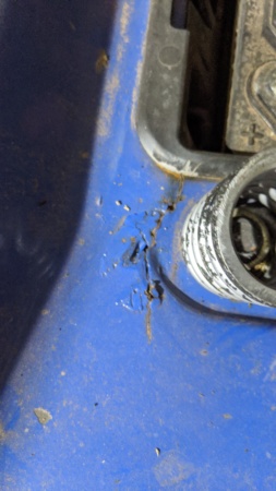

Couple surface things that will need some attention.
MR-LT1K Refresh Img_2334
Need to fix this ever growing crack.  I had it fixed for a few years, but it came back.

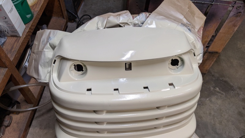

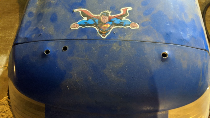

I also would like to take care of a couple holes in the nose where I had a nilight bar installed.
MR-LT1K Refresh Img_2333

Best thing you can do to fix those cracks is drill a hole at the end and then weld it. It worked for Mutt's fenders.

Yeah this will be the 2nd or 3rd time to do it.  I've done the drill a hole thing.  It does help a lot, but having extra lbs. of weight does not help when you push off that side of the fender.  May be thinking of some kind of brace under the fenders maybe?

Mutt has a plate someone with access to a sheet metal brake bent up and welded to the underside of the fender. When i switched fenders I cut the plate off of the old green ones and welded it on the underside of the red ones. It's a lot sturdier than without the reinforcement for sure.

Got the nose better, not great.  It works... good enough!

The crack on the fender, after fixing it by welding, you can put Sheetmetal under it and weld it in for strength.

Yeah.  I hate welding on this thin metal.

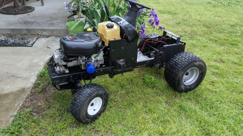

Few new updates.

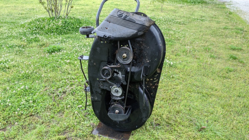

Frame all washed up as well as the mower deck...
MR-LT1K Refresh Img_2340
Poor sad deck... metal is in good shape, no rust holes, but that deflector has seen better days.
MR-LT1K Refresh Img_2341

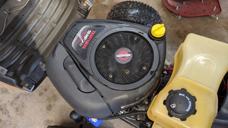

I don't think I have seen my engine this clean since I bought it.  Look at that yellow dipstick! So clean!
MR-LT1K Refresh Img_2339

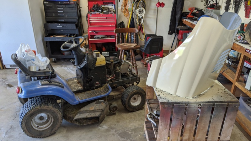

Put the hood back together and installed.
MR-LT1K Refresh Img_2342
Also greased spindles, wheels and reinstalled the dust caps I re-found!  LOL.
