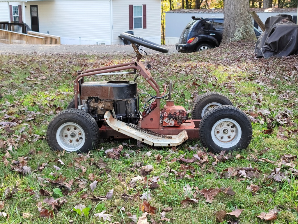

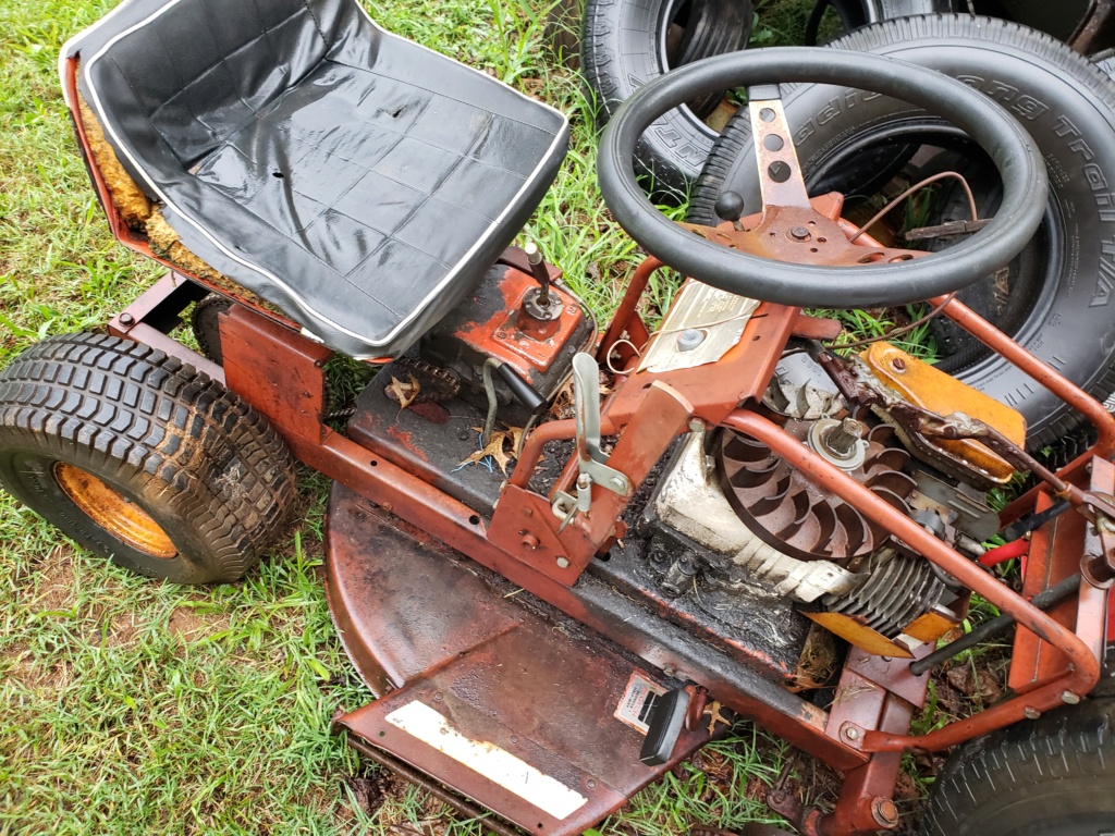

| I acquired a Rugg mower recently. Came with an 8hp that didn't run, A frozen mower deck, missing body and other little things. Kinda looked like a rat rod so thats the direction I'm gona go.  Love this steering rod. here it is with the 12hp shoe horned in.  Here its stripped, seat bracket chopped, and MTD running boards mounted.  | |

| This is gonna be a really cool build, definitely following this one!
By the way that drag link is fail thread material for sure, hahaha.  "This'll either wake you up or put you to sleep forever!"- Red Green "Whatever you do you should do right, even if it's something wrong." - Hank Hill - MTD Off-Road Build - Ford LT 110 Off-Road Build - Craftsman GT 6000 Off-Road Build - Sears LT11 Rat Rod Build *2019 Build-Off Winner!* - Allis B-110 x2, 710 & 716 - Wheel Horse 655, 953 & 500 Special - Case 444 - Bolens Versamatic & 1668 - Cub 106 & 124 - Ford 120, LGT 125 & 145 - White 1650 Yard Boss *I have 21 tractors and over 40 chainsaws, I need help* | |

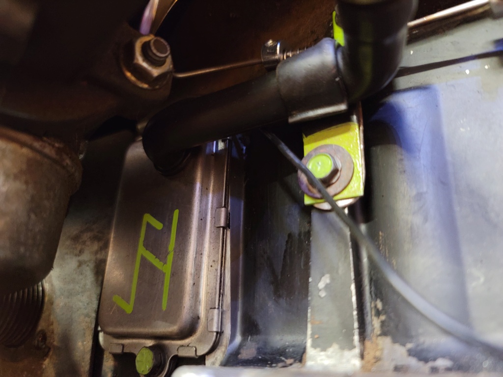

| Took the transmission off and tore it open. Found tons of grease. But none of it was touching the gears. So I cleaned it out, re greased it and added some gear oil to make a slurry. Painted it, and reinstalled it. Measured and bought a belt for it. Ordered a battery and welded up a holder for it.    | |
