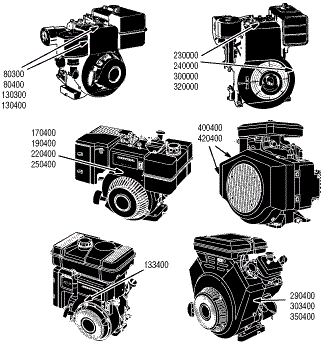

Oh ya an old cast iron 16hp B&S is more than enough! I have one, it's a 1977 model 326434 0023-01 and same as yours has a starter/generator. Is your model and date code not stamped on the top of the fan shroud?

Nah, all identifying marks and nameplates are long gone. Only thing left is the briggs symbol pressed into the blower shield. I haven't taken the cover off so I don't know if there's any information on the flywheel.
The starter-generator wasn't on the engine originally. I added that.

Should be stamped into the steel fan shroud probably somewhere under where you coil is located or on the curve under the gas tank.  In your case, the starter which I believe was a plate that I see was removed on yours. I'd still check under the coil. Maybe get lucky.
