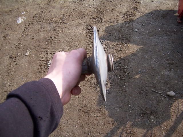

| yeah, I posed it there.. I can't believe it still didn't lift up a rear wheel. It was maxed out though. Still lots to be done. and my grinder just shit the bed, so that sucks... | |
Chunk Established Member
Age : 32 Join date : 2010-02-10 Points : 5973 Posts : 779 Location : Angus, Scotland
| Subject: Re: Custom Craftsman Rock-Crawler build March 14th 2010, 10:03 am | |
| I couldn't work without a grinder 0.o Sucks about that.
I like how it can just about run over your murray! Pretty sweet. That bolt is a big one. I'll be amazed if that broke. | |

I Think the axle would bend before the bolt bends or breaks! Lets hope that never happends. | |

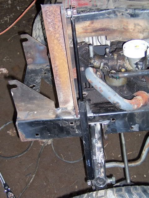

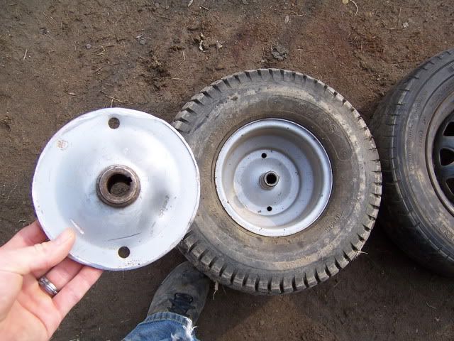

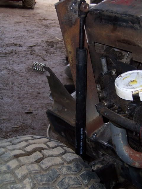

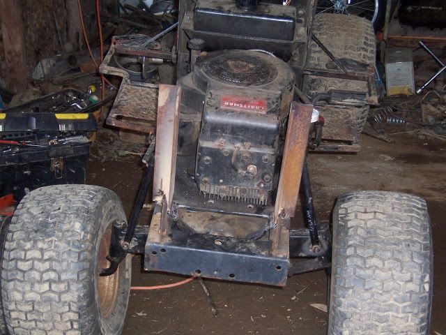

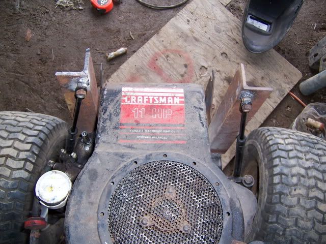

| Dangeroustoys, what brand are those, and where did you get them? I've yet to see good ones that cheap... Also, do they have 1 or 2 cutting groves on them? I see alot of the cheaper one only have 1, and the expencive ones have 2. And now, a little update... I've been doing 2 things at once... Sort of..lol.. First the front suspention, I wanted something that would keep it from suddenly tipping over because it has soo much travel. So I used gas charged struts that I found. They are the perfect length. I used thick ass angle steel to mount them on. (Ignore the exhaust, its just there to keep hot slag out of the motor, same with the white thing on the carb) I can still access everything on the motor, but now i need to make a custom exaust to clear the new shock tower. I welded bolts where I wanted to have the shock ends, and just have to thread the nuts on to keep them in place. Both sides done... It actually works quite well. I'll have to make a video of it to show it in action... It makes cool "woosh woosh" sounds when you cycle it back and forth. lol! And yes, the hood clears it no problem! And I started on the rear wheel swap, I've got some 13" honda wheels and tires, which will be replaced with something more aggresive. I hope I don't grenade the transaxle! I also took one of the two rear tires i had that dont hold air, and cut up the wheel until I had just the hub and a plate to mount some wheel studs onto. The plan will be to weld them onto the axle shafts, and bolt the wheel to them. Another veiw... So Thats it for now... I'm gonna go out today and get a new angle grinder... I wanted a dewalt but I'd rather not spend that much... I'm gonna spend more then I want to anyway.. I'm looking at a Skil at lowes for $30 or a kawasaki at tractor supply for $40.... I'm gonna try them out and see what I think... I may just have to cough up the $$$$ for the Dewalt though... What do you all think? What do you guys use? | |

| This is the link for the bits i have : http://www.northerntool.com/shop/tools/product_200313494_200313494I think mine have one slot- but they cut damn good- im impressed- plus saves me from buying a ton of drill bits. I like those lifts on the front axle- its cool y can still run the hood ( good thing for those tall craftsman hoods). Those rear wheels will be huge! Add some mud tires n itd be beefy. Y know, the way it works is if y buy a powertool cheep- thats what y get. id spend a lil more n buy a dewalt then youll have it a long time . Ive always been told " dont go cheep on stuff- itll bite y back later " by my dad- he bot his first dewalt 9.6 volt screw gun many years ago, he ran thru 2 sets of batteries before the armature finally gave out - he swears by dewalt. I bot my 12volt screw gun at a yard sale a few years back - for like $10 , well used, had the battery, charger and flashlight - i still have it. | |
