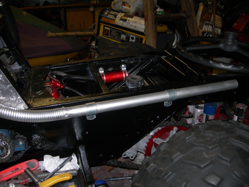

| Painted and installed the exhaust. I'll run it like this for a while. if its too loud, i'll add a dirtbike silencer I have kicking around.   Added the Main power switch to the dash. From the left, Toggle switch -Lights, pull switch - Main power, voltmeter, ignition key, and pop up circuit breaker. Ignition operates the starter and engine kill only, main power switch controls everything else. Circuit breaker protects start system, main power switch has a fuse built on it. Red light is low oil warning light.  | |

| Sharp lookin, and nice exhaust with the flexible pipe and clamps. ( Luckily I can also get that flexible pipe here, all tho in rather large sizes ). | |

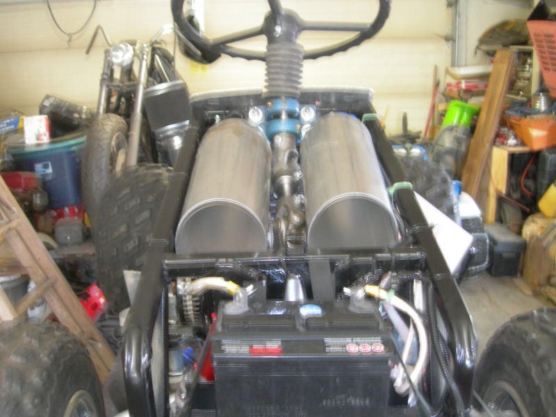

| Due to space constrictions, I have to build a custom fuel system. I decided to go with twin 5" dia, x 10" tanks. They will fit under the hood, be filled from the same filler, and be connected by a 1" tube across the lower ends. The tanks will be run to a single shut off, with a line from each tank at the top end to allow for fuel slosh under accelaration to prevent starvation.  Fitted a polished aluminum checker (tread)plate tunnel cover.  And a spring loaded twist latch so I don't land on my arse  | |

 | Subject: Re: Mastercraft Off road project April 24th 2013, 7:12 pm | |
| I like those fuel tanks. Where did you get them? | |
richie thomas Veteran Member
Age : 27 Join date : 2011-08-04 Posts : 1434 Location : east dublin georgia
 | Subject: Re: Mastercraft Off road project April 24th 2013, 7:19 pm | |
| - truckin42 wrote:
- I like those fuel tanks.
Where did you get them? im pretty sure he made them | |

 | Subject: Re: Mastercraft Off road project April 24th 2013, 8:37 pm | |
| The tanks are just pieces of 5" exhaust tubing cut to 10" long I haven't cut all the ends and fittings yet. still trying to figure out the mounting brackets. It's close gentlemen, with the fuel tanks, it's a rideable machine, even without hte bodywork. Pulled my hernia this morning. took the afternoon off. spent it sanding the nose piece, and drinking beer | |
