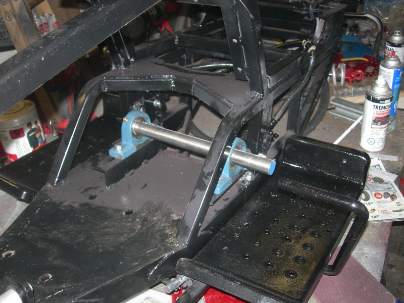

| More pics Rear Axle assembly  Front suspension in, with lower steering column  Jackshaft loosely in place  | |
